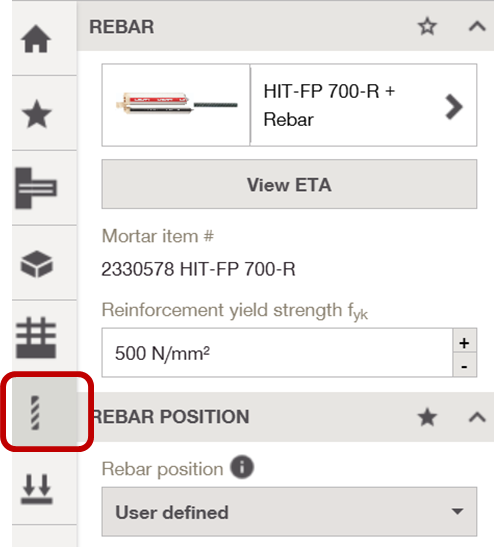

  1. Open the Post-installed rebar tab
    In your Post-installed rebar design workspace, navigate to the Post-installed rebar tab on the left-hand side of the screen.

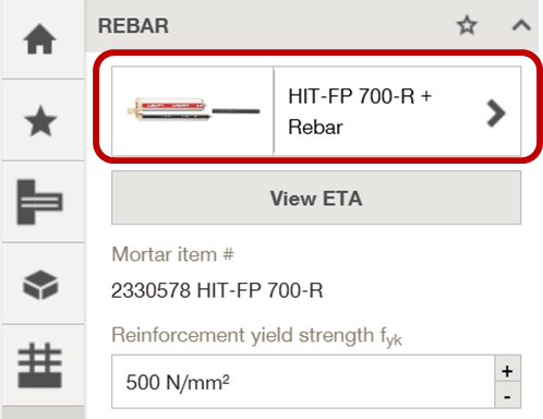

  2. Select the product
    Under Rebar, select the appropriate product.
    Click View ETA to open the corresponding product approval document.
    Note: Mortar item number associated with selected product is displayed here.

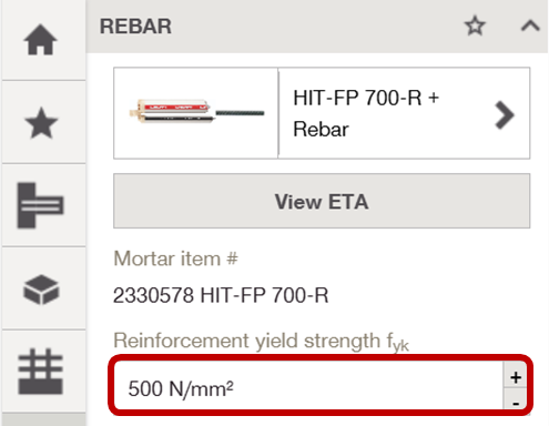

  3. Input reinforcement yield strength
    Enter the value of Reinforcement yield strength.

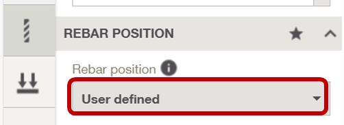

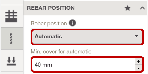

  4. Define rebar position
    Rebar position can be either user defined or automatic.

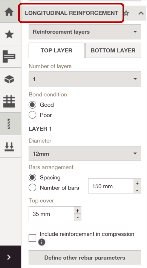

    If user defined is selected, enter longitudinal reinforcement details.
    If automatic is selected, the software will propose a solution considering minimum and maximum reinforcement requirements. Enter Minimum cover for automatic.
    The section on longitudinal will be temporarily disabled for this selection.

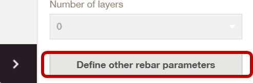

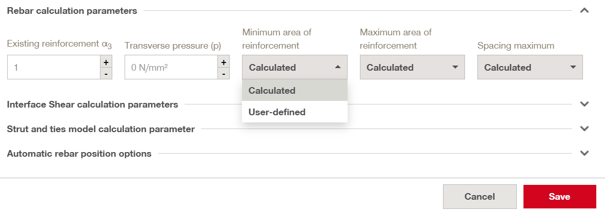

  5. Define other rebar parameters
    Click on Define other rebar parameters.
    In the pop‑up window, adjust the rebar calculation parameters as needed and click Save.
