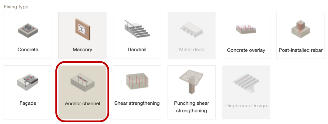

  1. Select the fixing type
    Choose Anchor channel from the fixing type options.

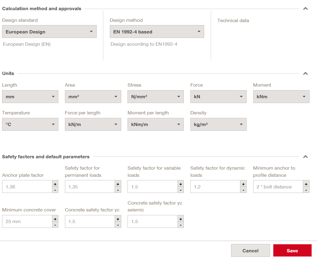

  2. Customize settings (optional)
    If needed, adjust:
    • Calculation method and approvals
    • Units
    • Safety factors and default parameters
    Click Save once finished.

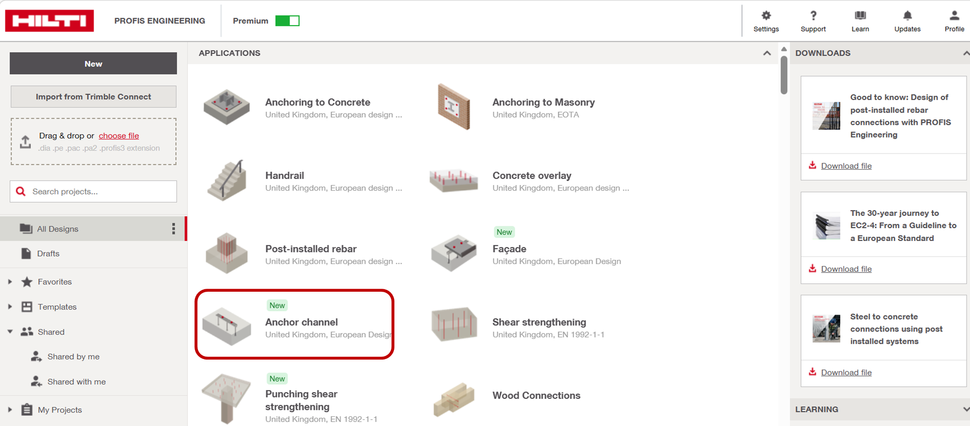

Alternative access method
On the PROFIS Engineering home page, you can also click the Anchor channel tile directly under the Applications section in the center panel.
