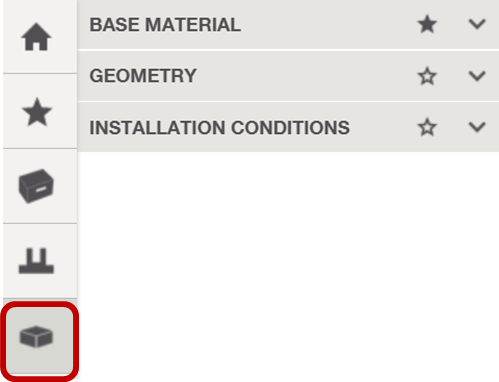

  1. Open the Concrete material tab
    In your Anchor channel design workspace, navigate to the Concrete material tab on the left-hand side of the screen.

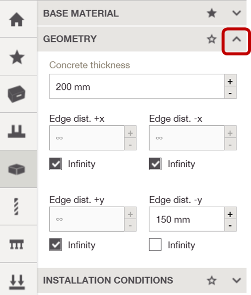

  1. Go to Geometry
    Here you can type in the concrete thickness value and edge distances in x and y directions. Alternatively, use the “+ / –” controls to increase or decrease the values.
  2. Use the infinity edge option
    Select the Infinity edge option in case of large edge distances.
Tip
Changes to concrete thickness or edge distances can affect available design space and may trigger warnings or automatic updates in later steps.
