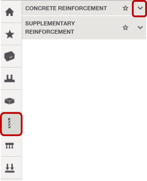

  1. Open the Concrete reinforcement section
    In the Facade design workspace, navigate to Concrete reinforcement tab → Concrete reinforcement section in the left‑hand navigation panel.

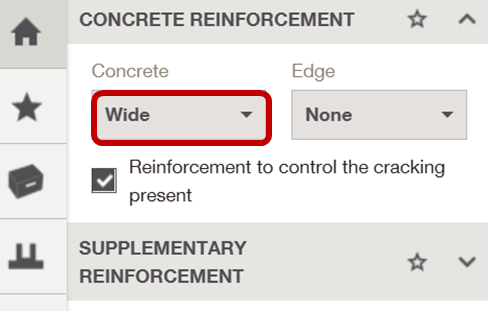

  2. Define reinforcement density in the concrete member
    Under Concrete, select the reinforcement density from the dropdown menu:
    1. None – No relevant reinforcement present
    2. Wide – Widely spaced reinforcement
    3. Dense – Closely spaced reinforcement
    This selection represents the overall reinforcement density in the concrete member and affects crack control assumptions and concrete behaviour around the anchor.

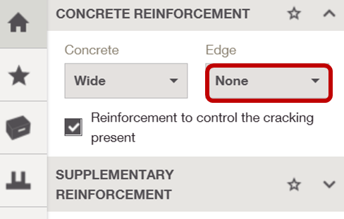

  3. Define edge reinforcement
    Under Edge, choose the option that best matches the reinforcement condition near the concrete edge:
    1. None – Select if there is no edge‑parallel reinforcement influencing concrete breakout behaviour.
    2. Straight – Select if straight reinforcement bars are present near the edge without additional confinement.
    3. Straight and closely spaced stirrups – Select if straight bars are present together with closely spaced stirrups providing enhanced confinement near the edge.
    This selection influences how PROFIS Engineering evaluates edge‑related concrete failure modes and the contribution of reinforcement to load transfer.

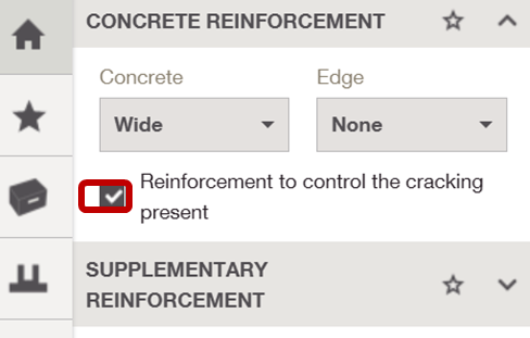

  4. Specify crack‑control reinforcement
    Enable Reinforcement to control the cracking present if the concrete member includes reinforcement specifically intended to limit cracking under service loads.
