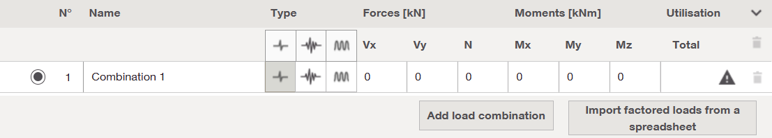

    In your facade design workspace, scroll to the Load combination panel at the bottom of the screen.
    Here you will see a table listing each load combination (varies depending on the selected fastening system and load definition), including:
    1. Load type
    2. Design & sustained load inputs
    3. Tension, shear or moment
    4. Strength utilisation

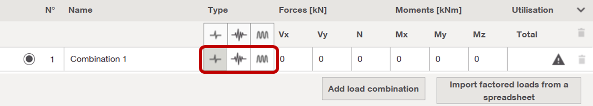

  2. Edit existing combinations
    Click on the static, seismic or fatigue design icon to switch the Load type.
    Click inside any cell for forces/moment to type new values.
    Your changes automatically update in the table and the drilling length is calculated.

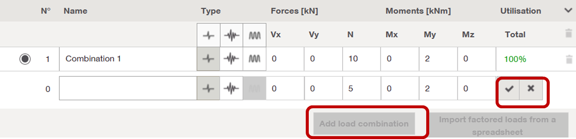

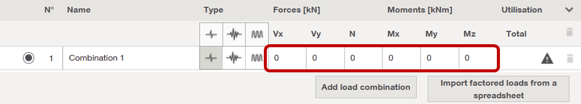

  3. Create a new load combination
    Click Add load combination.
    This creates a blank row where you can enter your loads.
    Enter load details and click ✓ (apply) or ✖ (cancel) icons to confirm or discard your input, respectively.

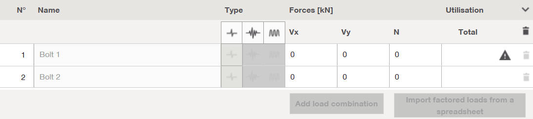

    Note: When Load per bolt (Load definition) is selected, it is not possible to add load combination.

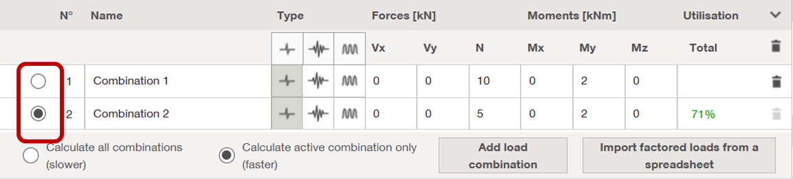

    Select the radio button to switch the active load combination.

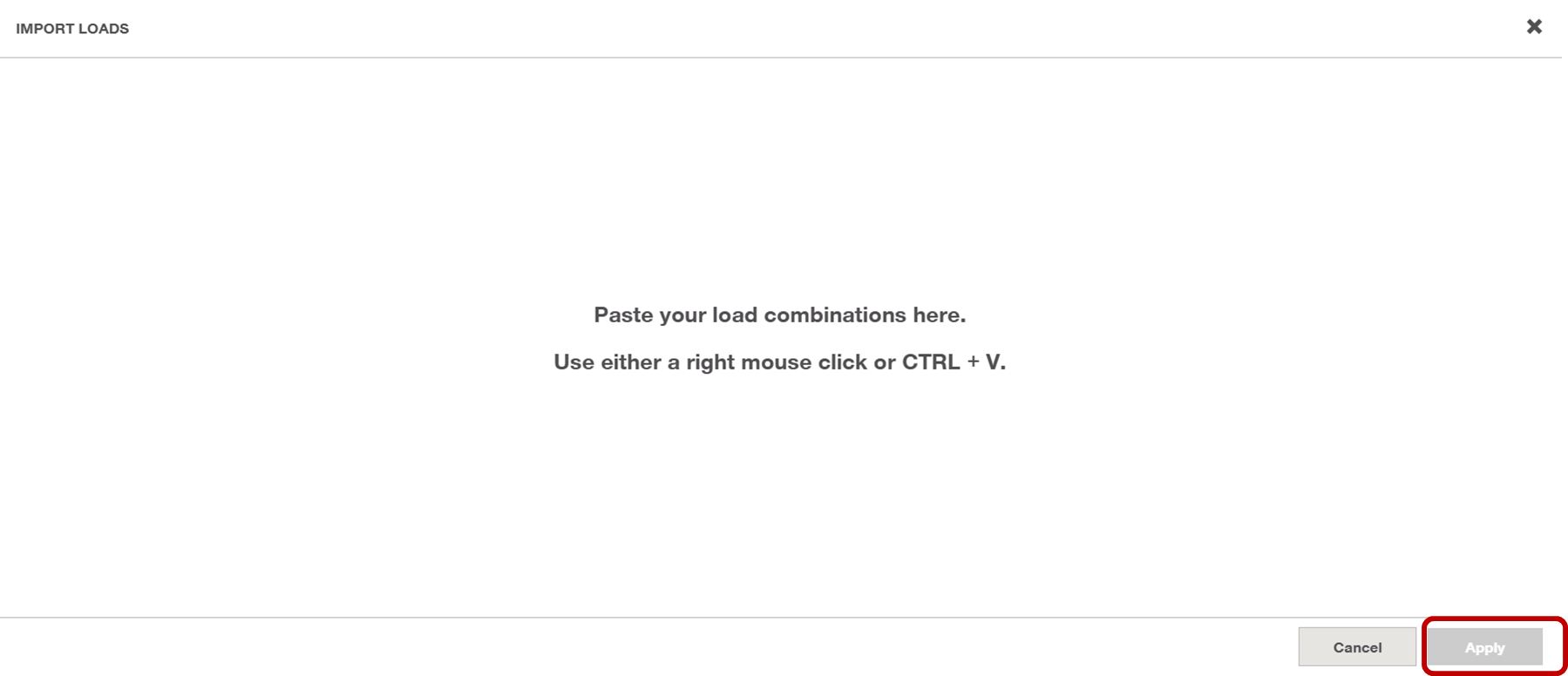

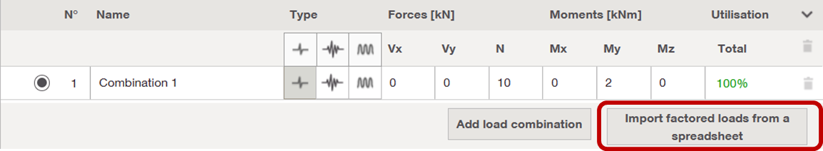

  4. Import factored loads from a spreadsheet
    Click Import load combinations.
    A pop‑up will appear with a paste field.
    Steps to import:
    1. Copy your factored load table from Excel or another source.
    2. Paste it into the pop‑up window.
    3. Click Apply.
      The system automatically fills in the load combinations based on your pasted data.

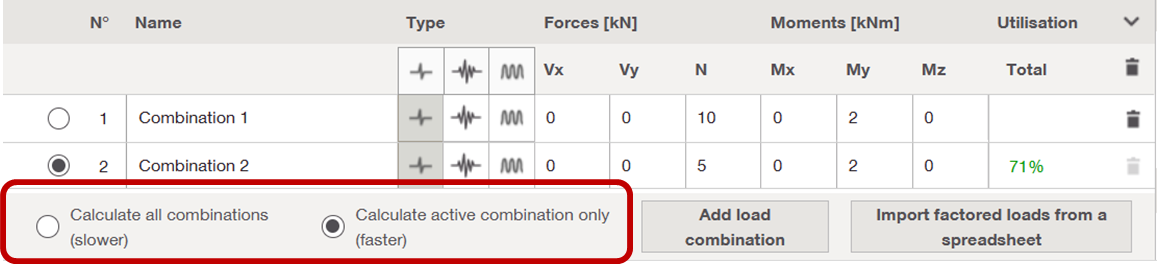

  1. Choose calculation mode
    Below the load combination table, select one of the two calculation options, when working with multiple load combinations:
    • Calculate all combinations (slower)
    • Calculate active combination only (faster)

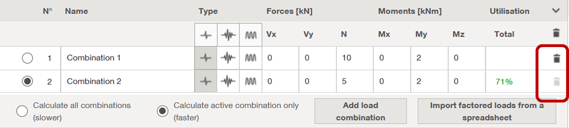

  2. Delete a combination
    Click the trash bin icon on the right-hand side of any load combination row.
    Deleted combinations cannot be recovered, so ensure that you remove only those no longer needed.

To input Loads per bolt, go to Load type → Load definition, and select Per bolt.
The Load combination panel will update to allow loads per bolt.
