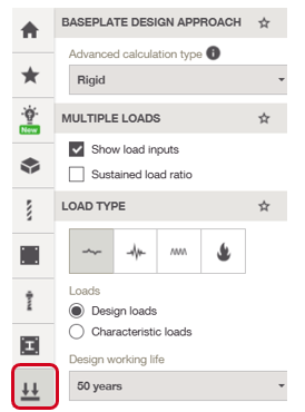

    In the Anchoring to Concrete module, go to Loads / Calculation Type.
If needed, refer to the article. How to select load type and design method in Anchoring to Concrete module

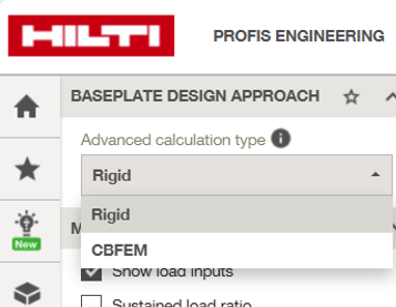

  1. Go to Baseplate Design Approach
    Under Advanced calculation type, select CBFEM Design from the dropdown menu.

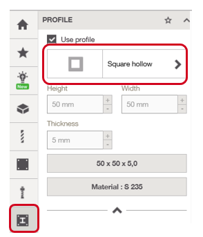

  1. Open the Profiles tab
    Select the desired attachment profile from the available options.

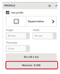

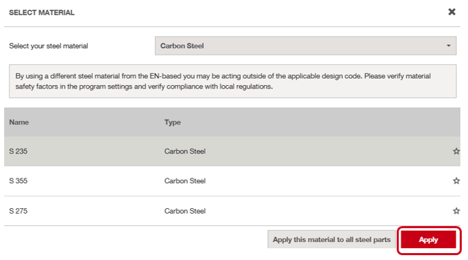

  1. Open the Material tab
    Select the desired profile material from the available options, then select Apply.

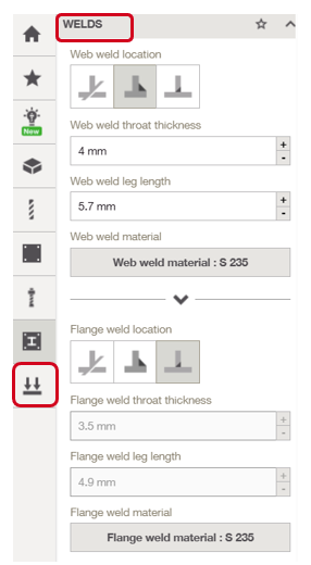

  1. Go to Welds
    Select the desired weld type, size, and material.

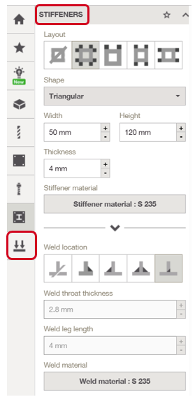

  1. Go to Stiffeners (Optional)
    Select the desired stiffener layout from the available options. When stiffeners are enabled, enter the required stiffener properties, including shape, width, height, thickness, and material.
