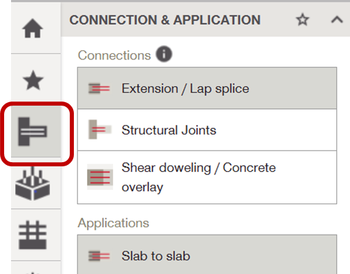

  1. Open the Application tab
    In your Concrete to Concrete design workspace, go to the Application tab located on the left-hand side of the screen.

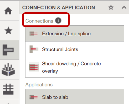

  2. Select connection type
    Under Connections & Applications, choose the Connection type that best fits your design scenario.

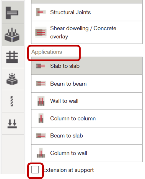

  3. Select an application
    Under Connections & Applications, select the appropriate Application for your chosen connection type.
    The available applications will update depending on the selected connection type.
    If applicable, you can also enable Extension at support.
