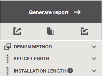

  1. Go to the Results and Notifications panel
    In your Concrete to Concrete design workspace, go to the Results and Notifications panel on the right-hand side of the screen.

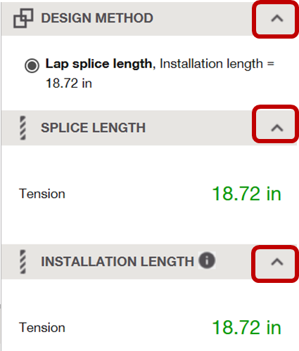

  2. Review design results
    Expand or collapse the section using the arrow next to it.
    Here, you can review the lap splice length and installation length.
    Note: This part of the output can change based on the connection type selection.  Point 1 and 2 are representative of Lap splice connection.

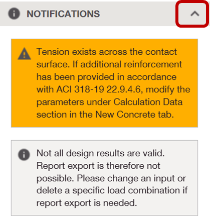

  3. View Notifications
    Open the Notifications section to see design tips, warnings, and error messages that may require your attention.

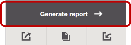

  4. Save and generate detailed design report

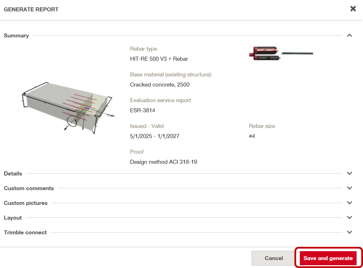

    Click Generate report on the right-hand side of the screen.
    In the pop‑up window, adjust report settings if needed, then select Save and generate to create a complete detailed design report.
