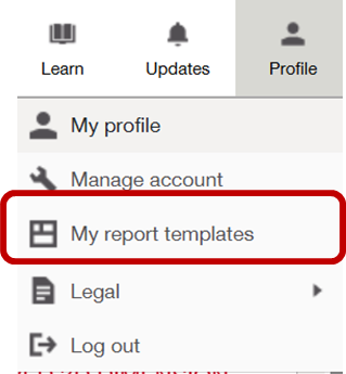

  3. Open the Profile menu
    Click the profile icon in the top-right corner of the screen.
  4. Navigate to My report templates
    From the dropdown menu, select My report templates.

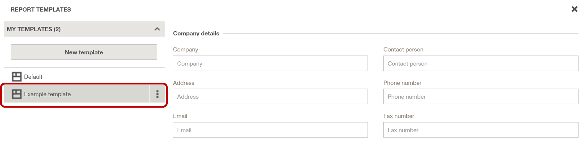

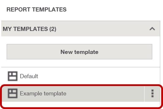

  5. Navigate to report template
    In the pop-up window, navigate to the report template that you want to modify.
  6. Modify the report template
    You can customize the following sections:
    • Company details
    • Branding*
    • Report layout
    • Report header and footer*

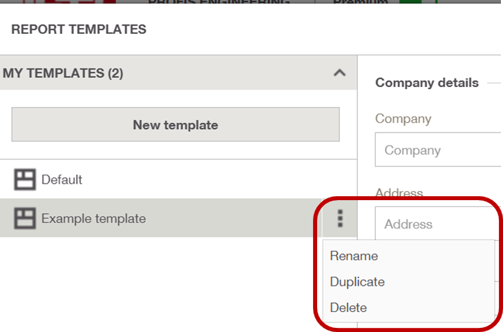

  7. Rename report template (optional)
    Click on the report template that you want to rename.
    Click on the three dots that appear next to the template and select Rename from the dropdown list.
  8. Delete report template (optional)
    Click on the report template that you want to delete.
    Click on the three dots that appear next to the template and select Delete from the dropdown list.
