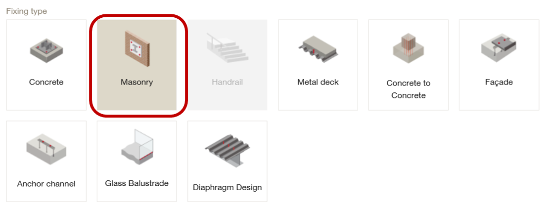

  1. Select the fixing type
    In the pop-up window, choose Masonry from the fixing type options.

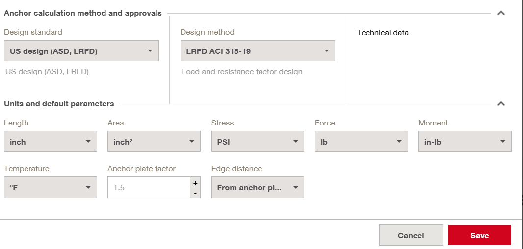

  2. Customize settings (Optional)
    If needed, adjust:
    • Anchor calculation method & approvals
    • Units and default parameters
    Click Save once finished.

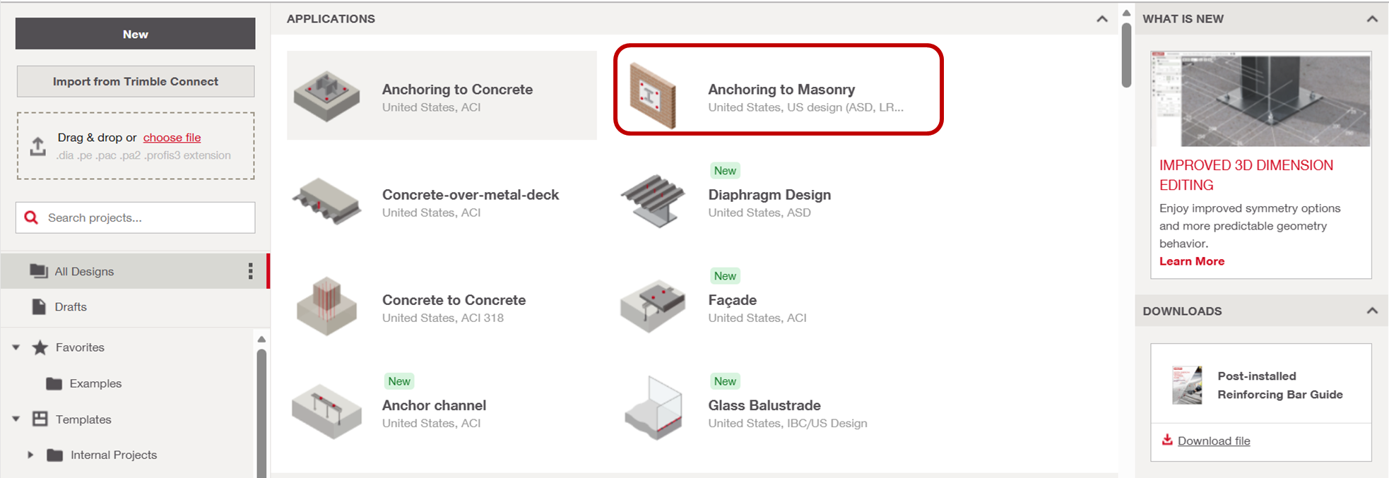

Alternative access method
On the PROFIS Engineering home page, you can also click the Anchoring to Masonry tile directly under the Applications section in the center panel.
