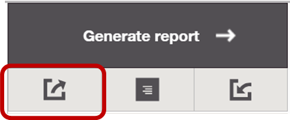

  1. Click the Export icon
    In your Anchoring to Masonry design workspace, go to the panel on the right-hand side of the screen and click the Export icon.

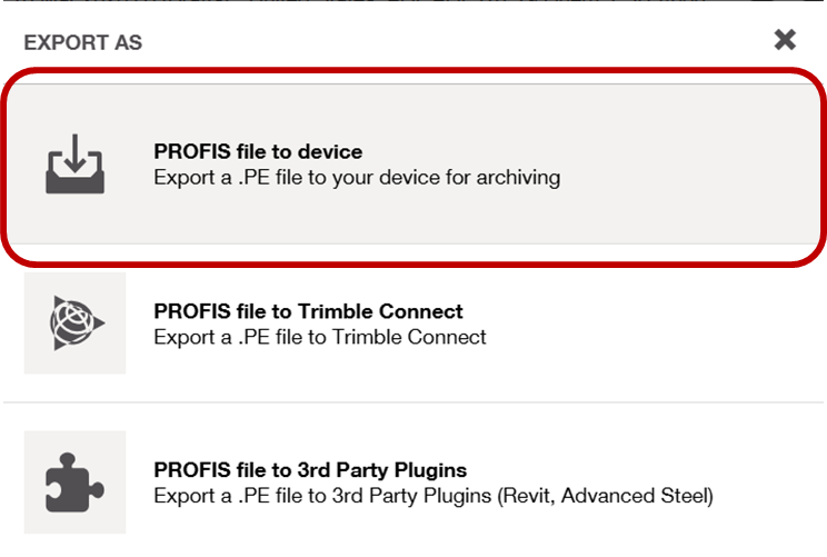

  1. Save the PROFIS design file
    From the export options, choose PROFIS file to device.
    The file will be automatically saved to your downloads folder or your predefined system folder.

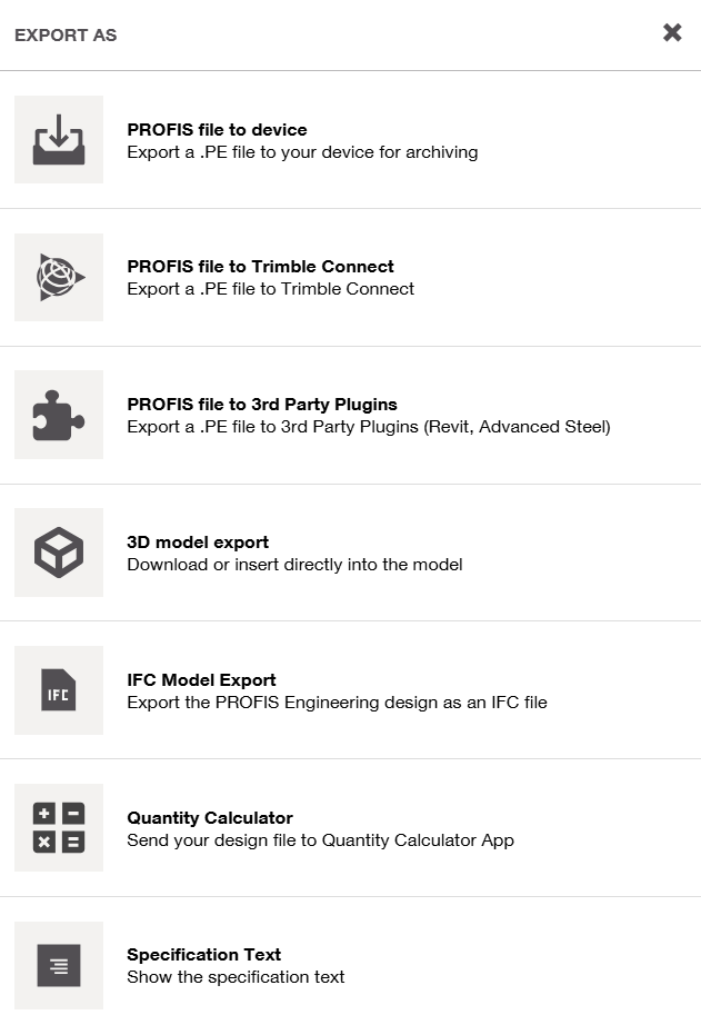

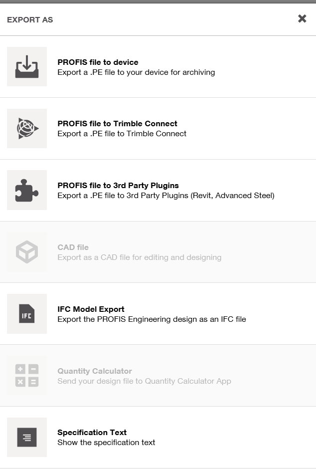

  2. Export additional formats (optional)
    If needed, select one of the other available export formats to download your design information in alternative file types (not all options are available for Masonry).
