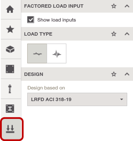

  1. Go to Loads / Calculation Type
    In your Anchoring to Masonry design workspace, go to the Loads / Calculation type on the left-hand side of the screen.

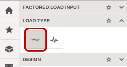

  2. Select the Load type
    Under Load type, select one of the following:
    • Static load
    • Seismic load.
      The Static load option is enabled by default.

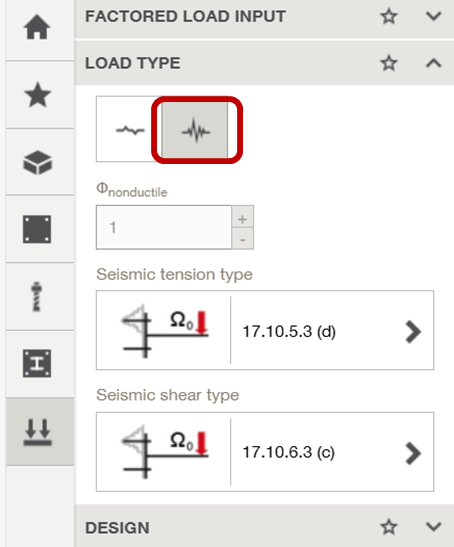

  3. Define Seismic load type (if applicable)
    Go to Load type and select the seismic load option.
    Default seismic tension type and seismic shear type is displayed.

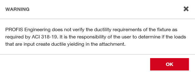

    Read the warning message and click OK.

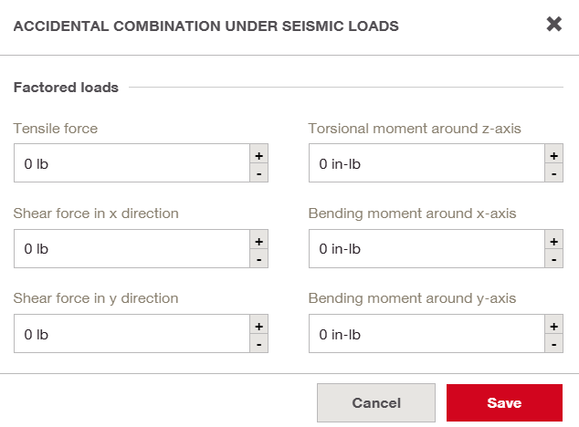

    In next pop-up window, click Yes to re-input factored loads.
    Enter the factored loads and click Save.

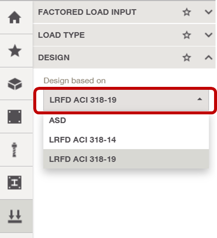

  4. Select the design method
    Go to Design and select the desired option from the dropdown menu.
Tip
If you switch to seismic loading, always verify your load inputs.
