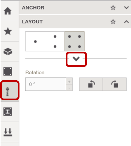

  1. Open the Anchor tab
    In your Anchoring to Masonry design workspace, navigate to the Anchor tab on the left-hand side of the screen.

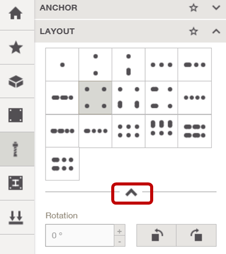

  2. Go to Layout
    Click the arrow to expand the Layout menu, then choose the desired anchor layout from the available options.
  3. Adjust Rotation
    Navigate to Rotation. Use rotation controls to turn the layout. Each click rotates the layout by 90 degrees.
