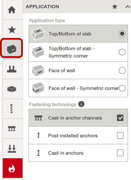

  1. Open the Application tab
    In your Anchor channel design workspace, navigate to the Application tab on the left-hand side of the screen.
    Here you can define:
    • The structural application (geometry and orientation)
    • The fastening technology used

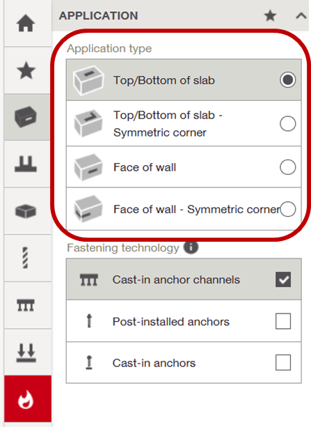

  2. Select the Application type
    Under Application type, choose the option that best represents your installation condition:
    • Top / Bottom of slab
    • Top / Bottom of slab – Symmetric corner
    • Face of wall
    • Face of wall – Symmetric corner

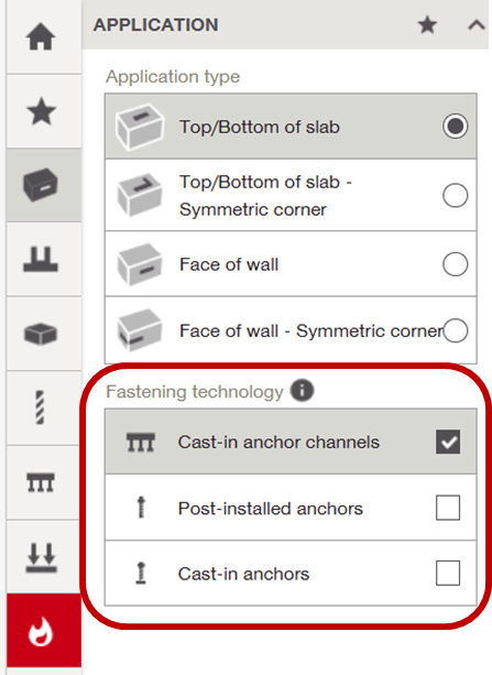

  3. Select the Fastening technology
    Under Fastening technology, select one or more applicable options:
    1. Cast‑in anchor channels
    2. Post‑installed anchors
    3. Cast‑in anchors
    You can enable multiple technologies if the design allows alternative fastening concepts.
  4. Confirm changes when prompted
    If you change the application type after entering other design inputs, PROFIS Engineering displays a warning message.
    Click OK to confirm and proceed.
