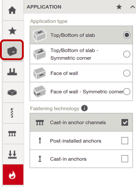

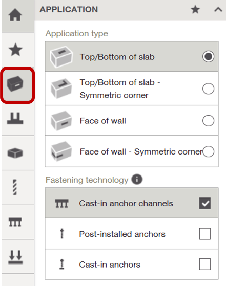

  1. Open the Application tab
    In your Facade design workspace, navigate to the Application tab on the left-hand side of the screen.
    Here you can define:
    • The structural application (geometry and orientation)
    • The fastening technology used

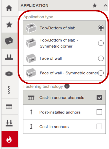

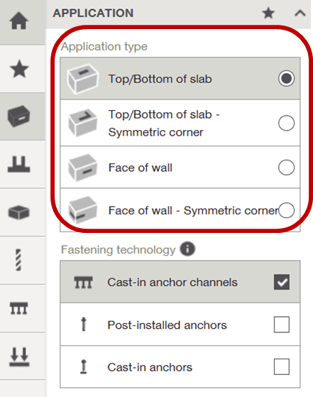

    Under Application type, choose the option that best represents your installation condition:
    • Top / Bottom of slab
    • Top / Bottom of slab – Symmetric corner
    • Face of wall
    • Face of wall – Symmetric corner

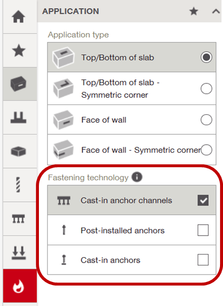

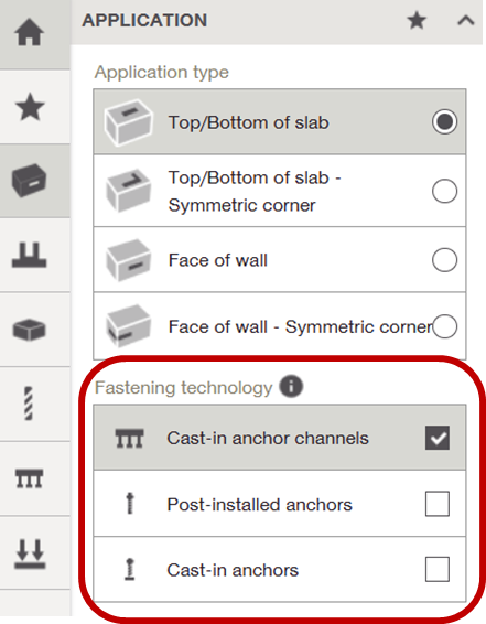

  3. Select the Fastening technology
    Under Fastening technology, select one or more applicable options:
    1. Cast‑in anchor channels
    2. Post‑installed anchors
    3. Cast‑in anchors
    You can enable multiple technologies if the design allows alternative fastening concepts.
