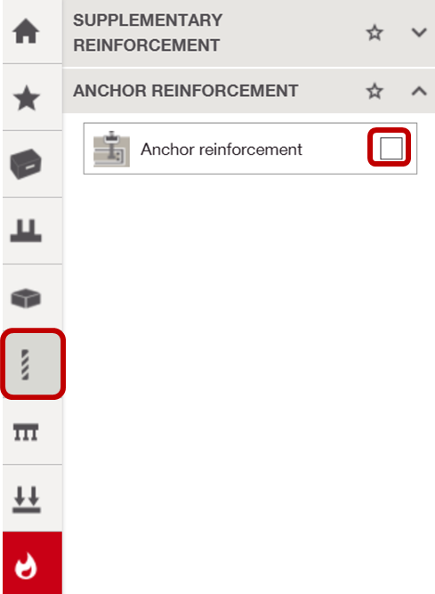

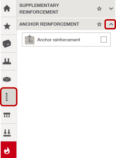

  1. Open the Anchor reinforcement section
    In the Facade design workspace, navigate to Concrete reinforcement tab → Anchor reinforcement section in the left‑hand navigation panel.
  2. Enable anchor reinforcement
    By default, anchor reinforcement is disabled.
    Activate the Anchor reinforcement checkbox. It is available only if the fastening technology selected is Cast-in anchor channels.

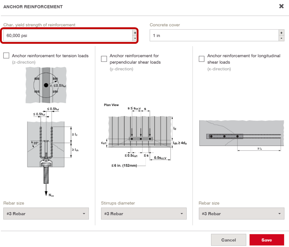

  3. Define material properties of the anchor reinforcement
    At the top of the pop‑up window, enter the Characteristic yield strength of reinforcement.

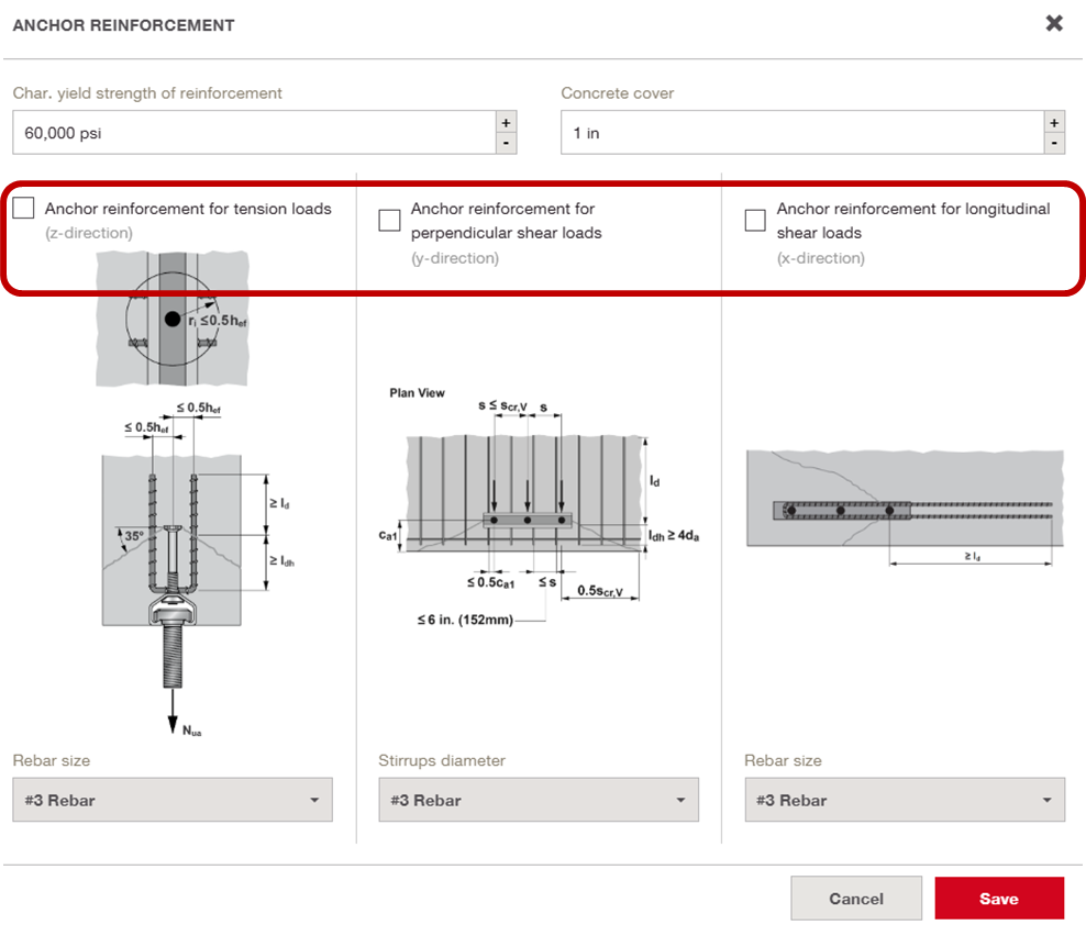

  4. Select the applicable reinforcement contribution
    Choose one or more reinforcement contributions based on how reinforcement is arranged relative to the anchor channel:
    1. Anchor reinforcement for tension loads (z‑direction)
      Use this option when reinforcement is installed to carry anchor tension forces.
    2. Anchor reinforcement for perpendicular shear loads (y‑direction)
      Select this when reinforcement crosses the potential shear failure plane.
    3. Anchor reinforcement for longitudinal shear loads (x‑direction)
      Use this option if reinforcement contributes to shear resistance along the anchor channel length.
    Each option activates a corresponding input panel with geometry illustrations to help you verify the reinforcement arrangement.

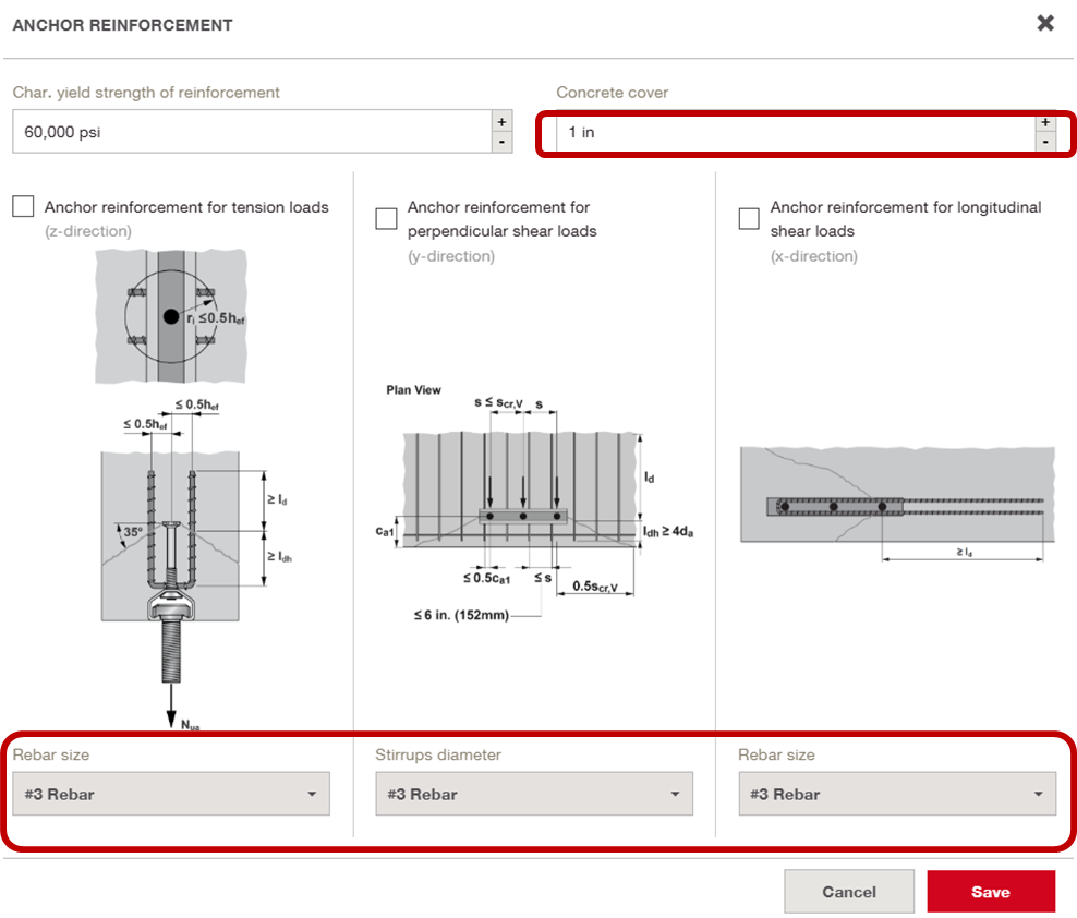

  5. Define reinforcement geometry and detailing
    For each selected reinforcement contribution, specify:
    • Reinforcement diameter
    • Concrete cover
    These inputs define the anchorage behavior and effectiveness of the anchor reinforcement.
    Use the schematic drawings shown in the dialog to confirm bar orientation and spacing assumptions.
