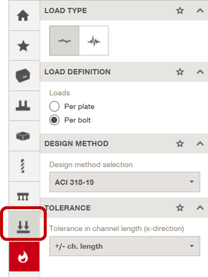

  1. Go to Loads / Calculation Type
    In your Facade design workspace, go to the Load type tab on the left-hand side of the screen.

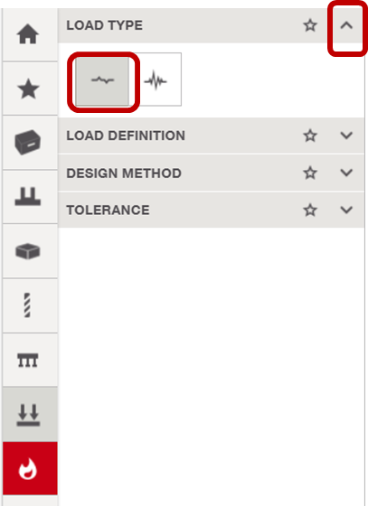

  2. Select the Load type
    Go to Load type and select the desired option.
    The Static load option is enabled by default.

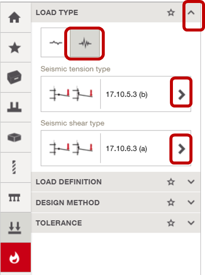

  3. Define Seismic load type (if applicable)
    Go to Load type and select the seismic load option.
    Select the seismic tension type from available options.
    Select the seismic shear type from available options.

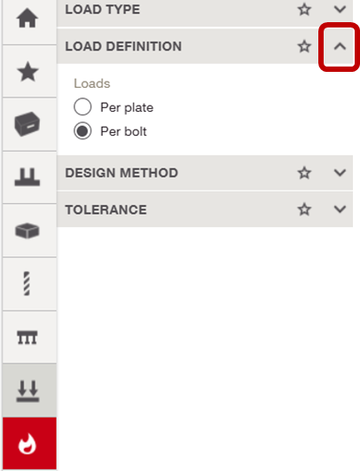

  4. Select load input type
    Go to Load definition and choose suitable load input type from available options.

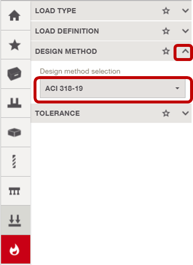

  5. Select the design method
    Go to the Design method and choose the desired option from the dropdown menu.
  6. Define Tolerance

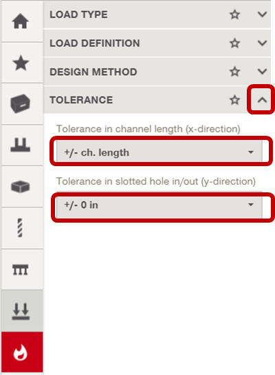

    Go to Tolerance and select the suitable option from dropdown menu.
    Note:
    • This section in enabled only for Anchor channels and Cast-in anchors.
    • The dropdown menu for Tolerance in slotted hole in/out becomes visible only when Load per plate input type is selected.

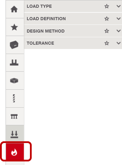

Tip
For guidance on firestop, click on Firestop selection tab on the left-hand side of the screen.
