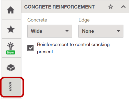

  1. Open the Reinforcement tab
    In your Anchoring to Concrete design workspace, navigate to the Reinforcement tab on the left-hand side of the screen.
  1. Go to Concrete reinforcement
    • Here you can select the most appropriate reinforcement condition from the dropdown menu for Concrete (longitudinal) and Edge (shear) reinforcement.
    • Check the Reinforcement to control cracking present box, if applicable.
