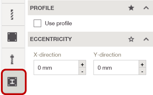

  1. Open the Profiles tab
    In your Anchoring to Concrete design workspace, navigate to the Profiles tab on the left-hand side of the screen.

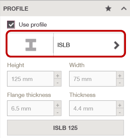

  1. Go to the Profiles section
    Check the Use profile option if you need an attachment. Select the desired attachment profile from available options.
    PROFIS Engineering default options are based on the standards typically used in your region or country.

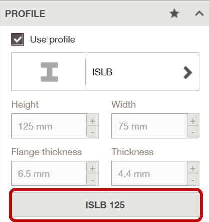

  1. Select the Profile Size
    Select the desired profile Size from the available options. Select the desired profile Size from the available options.

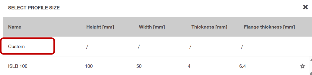

  1. Define a Custom Profile (Optional)
    If needed, choose Custom to define your own profile dimensions.
