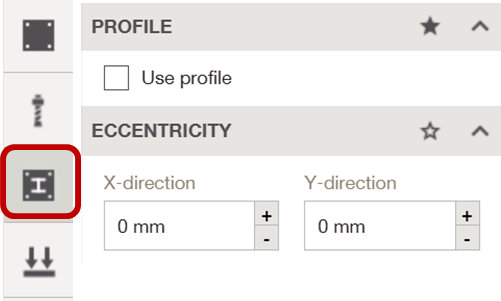

  1. Open the Profiles tab
    In your Anchoring to Concrete design workspace, navigate to the Profiles tab on the left-hand side of the screen.

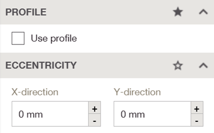

  1. Go to Eccentricity
    Here you can type in the eccentricity values or use the “+ / –” controls to increase or decrease it.

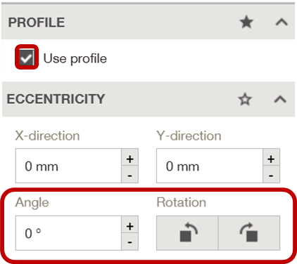

  2. Modify the attachment angle
    When Use profile is enabled, navigate to Angle to adjust the angle of the attachment profile. You can input load eccentricity values also without profile enabled.
