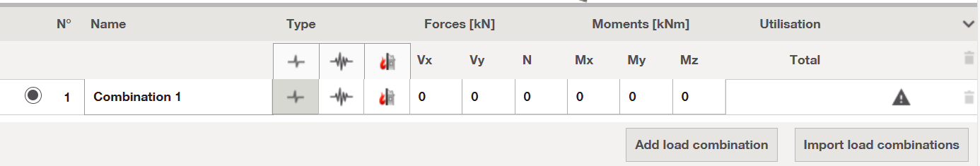

    In your Anchoring to Concrete design workspace, navigate to the Load Combination panel located at the bottom of the screen.
  2. Input loads

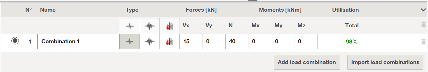

    Enter your required loads directly in the panel.
    You can also edit the loads using the 3D view of the design.

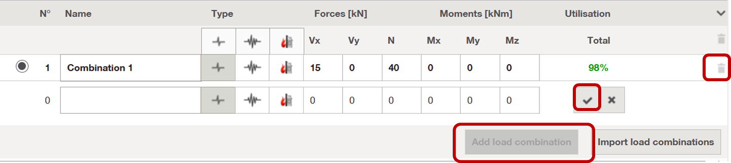

  3. Add load combinations
    Select Add load combinations to create a new combination from scratch.
    Enter the load details.
    Click the check mark to accept, or the cross mark to delete the entry.
    Click the delete symbol at end of row to delete selected load combination.

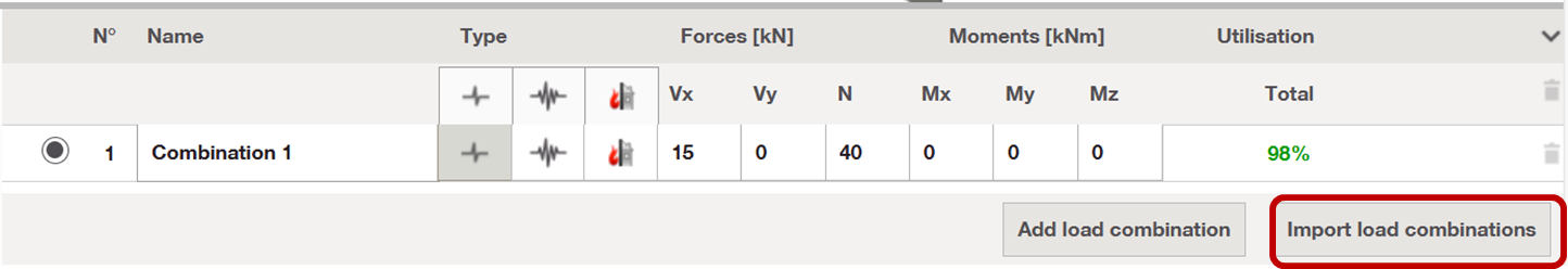

  4. Import load combinations
    Select Import load combinations.

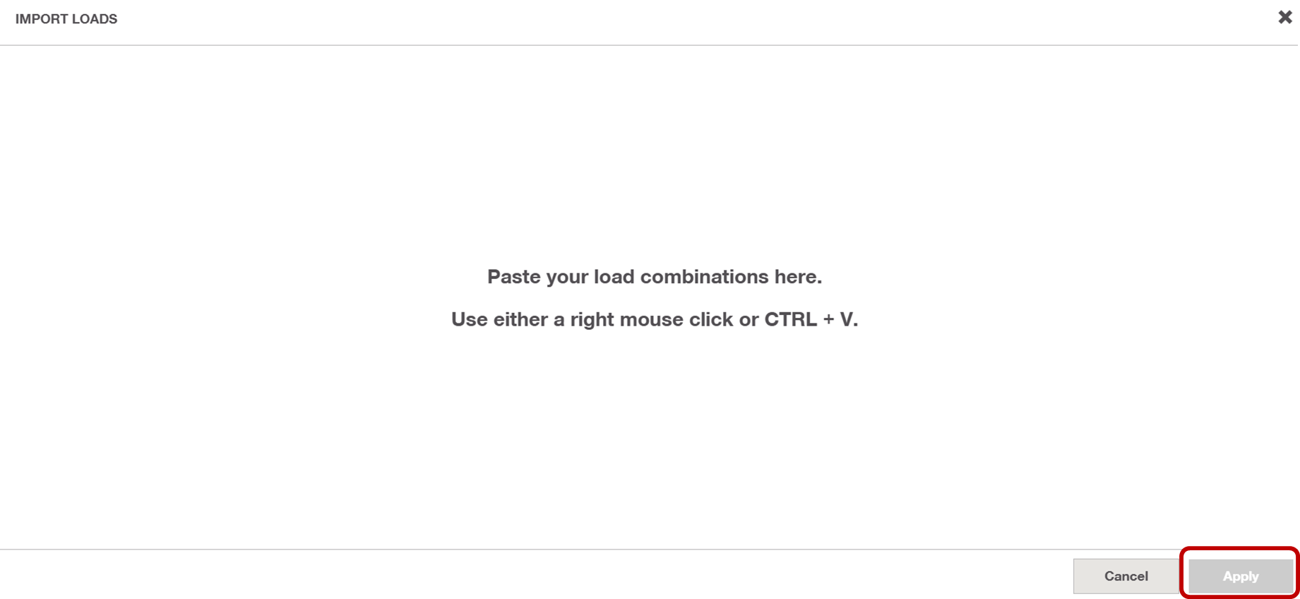

    Paste your load combinations into the pop‑up window.
    Click Apply to update the panel.

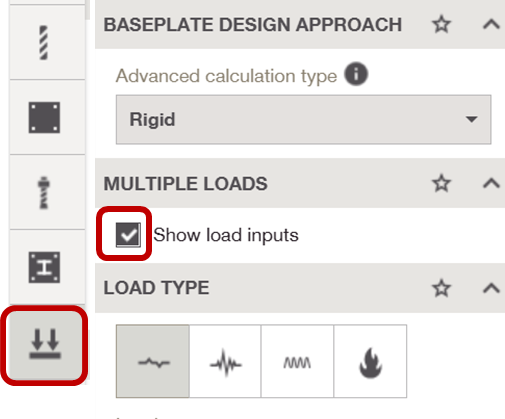

If the Load Combination panel is not visible, go to the Load / Calculation type tab on the left-hand side and enable Show load inputs.
