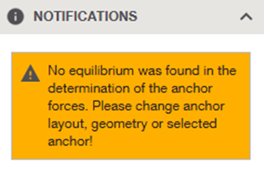

      If not, PROFIS Engineering shows warnings or error prompts in the Results and Notifications panel.
  2. Troubleshooting Notification (Scope Check) Messages
    • Read the full message
      Each notification explains:
      • What the issue is (e.g., minimum edge distance not fulfilled)
      • Where it occurs (e.g., a specific anchor or baseplate corner)
      • How to fix it (e.g., increase spacing, adjust layout, reduce loads)
    Follow the suggested steps or use the automatic fix prompt when available.

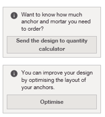

  3. Use warnings proactively
    Warnings that do not block design, they highlight:
    • Basic assumptions of the design
    • Proposed geometry improvements
    • Safer installation recommendations
    • Conditions close to the limit
    Relevant warnings also appear in the Design Report.
