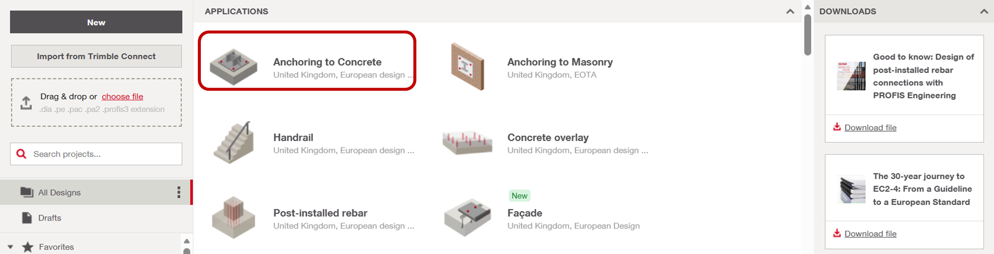

  3. Open the Anchoring to Concrete module
    Click New in the top-left corner. From the available options, select Custom design.

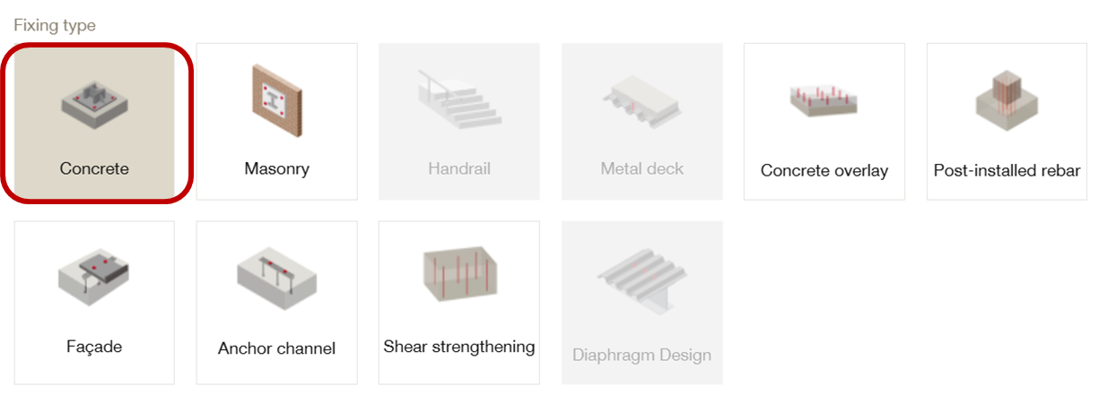

  1. Select the fixing type
    Choose Concrete from the fixing type options.

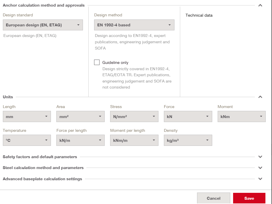

  2. Customise settings (Optional)
    If needed, adjust:
    • Anchor calculation method & approvals
    • Units
    • Safety factors and default parameters
    Click Save once finished.

Alternative access method
On the PROFIS Engineering home page, you can also click the Anchoring to Concrete tile directly under the Applications section in the center panel.
