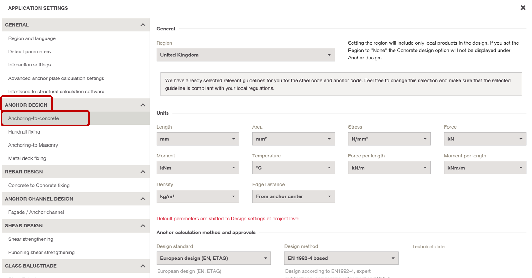

  3. Open the Setting menu
    Click the settings icon (⚙️) in the top-right corner of the screen.
  4. Navigate to design module
    In the left-side menu, go to desired design module under Application settings.

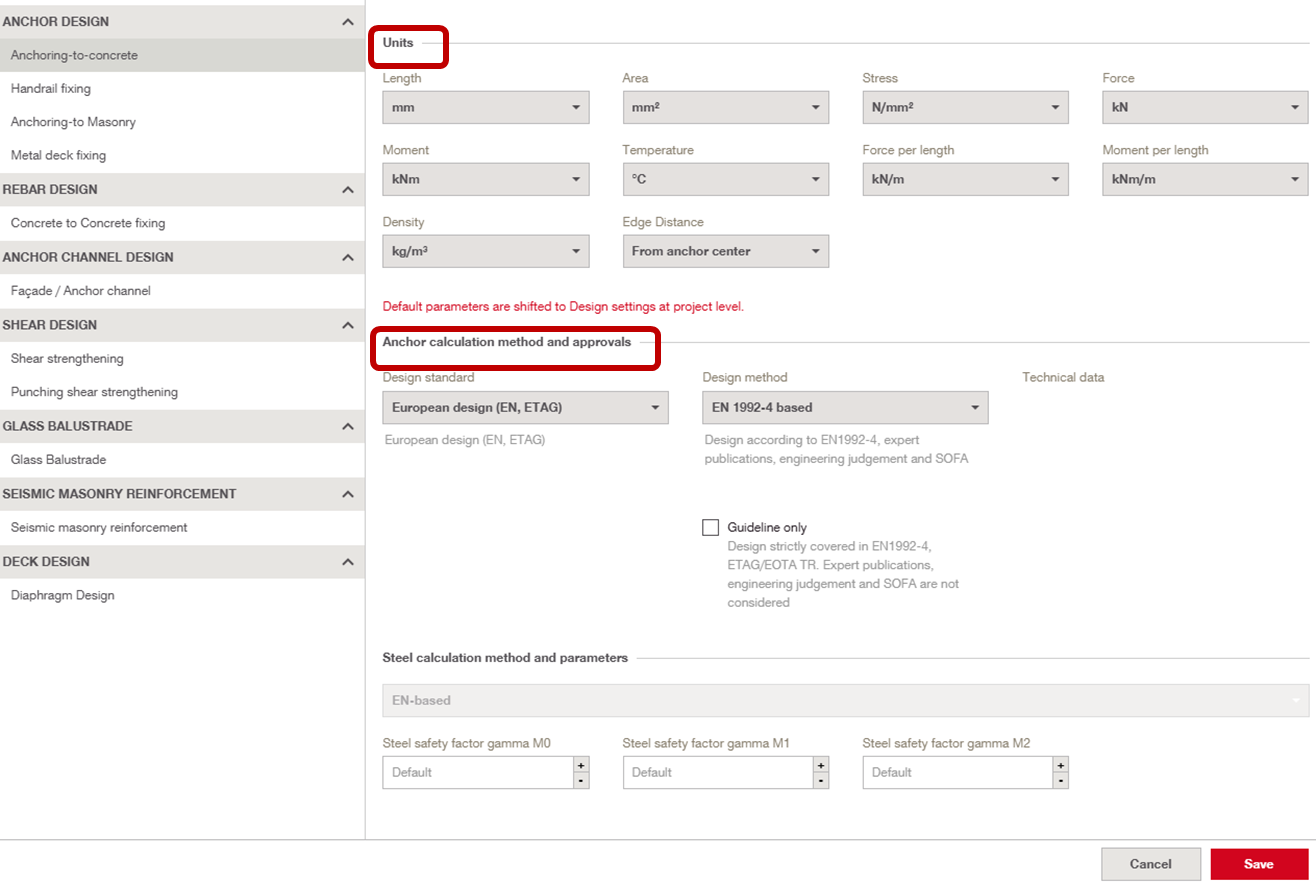

  5. Modify units
    Under Units and default parameters, update the unit settings according to your preference.
    These default units are initially based on the region you selected, but you can customise them as needed.
    Here, you can also modify the default design method.
    Note: You can also modify default units while starting a new design.
  6. Save your settings
    Your changes will be applied immediately.
