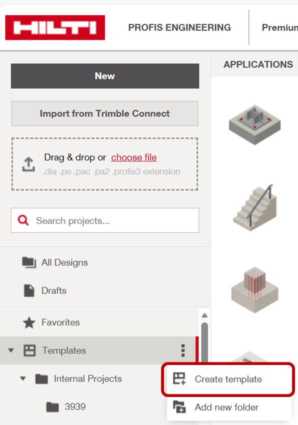

    Select Templates on the left-hand side of the screen.
    From the dropdown list, select Create template.
    Templates can also be created form the New design controls (Top left corner).

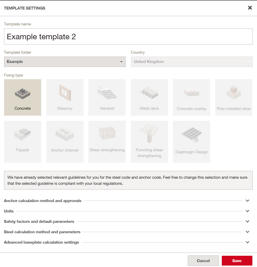

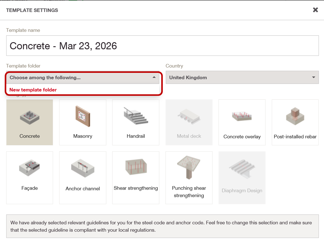

  4. Select the design module
    In the pop-up window:
    • Enter a template name.
    • Select location where the template will be saved; either create a new template folder or choose from pre-existing ones.
    • Choose your region.
    • Select fixing type (e.g., Concrete to concrete, Facade)

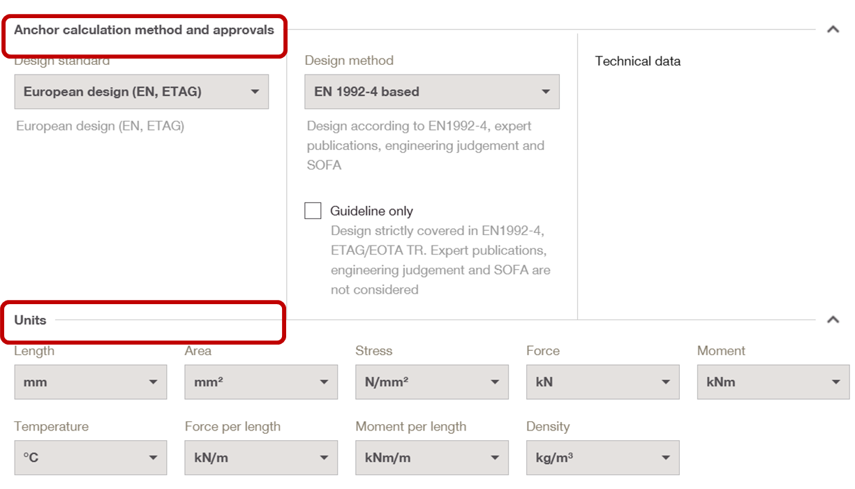

  5. Modify default design methods and units (Optional)
    In the same window, you can update:
    • Design method
    • Units
    • Safety factors and default parameters
    • Steel calculation method and parameters
    • Advanced anchor plate calculation settings
      Use arrow on the right, to expand or collapse a section.

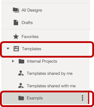

  7. Accessing your template
    In the PROFIS Engineering home page, go to Templates on the left-hand side of the screen and click on your template folder.
