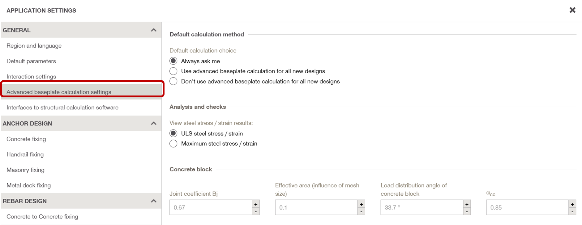

  3. Open the Setting menu
    Click the settings icon (⚙️) in the top-right corner of the screen.
  4. Navigate to Advanced baseplate calculation settings
    In the left-side menu, go to General → Advanced baseplate calculation settings.
  5. Modify Advanced baseplate calculation settings
    Under Advanced baseplate calculation settings, adjust the options as needed.
    You can modify settings related to:
    • Default calculation method
    • Analysis and checks
    • Concrete block
    • Check settings
    • Mesh
  6. Save your settings
    Your changes will be applied immediately.
