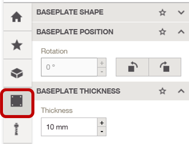

  1. Open the Baseplate tab
    In your Anchoring to Masonry design workspace, navigate to the Baseplate tab on the left-hand side of the screen.

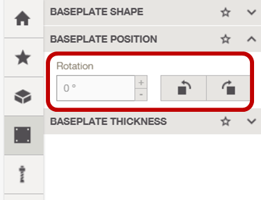

  2. Go to Baseplate position
    Use rotation controls to turn the baseplate left or right. Each click rotates the plate by 90 degrees.

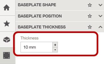

  3. Go to Baseplate thickness
    Here you can type in the thickness value or use the “+ / –” controls to increase or decrease it.
