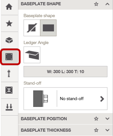

  1. Open the Baseplate tab
    In your Anchoring to Masonry design workspace, navigate to the Baseplate tab on the left-hand side of the screen.
  2. Select the Baseplate shape
    Go to Baseplate shape and enable the baseplate.

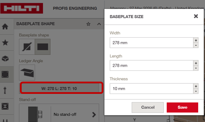

  3. Modify Baseplate dimensions
    Under Baseplate shape, click on the highlighted box to modify the baseplate dimensions and then click Save.
  4. Set the Stand-off condition
    Currently, PROFIS Engineering does not allow for stand-off conditions for anchoring into masonry.

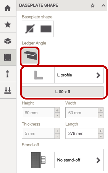

  5. Alternative Option: Ledger Angle
    PROFIS Engineering also allows you to select a Ledger angle instead of a baseplate.
    Note: When Ledger angle is selected, select the profile shape and size. You can also choose to customize the size.
