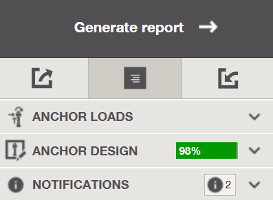

  1. Go to the Results and Notifications panel
    In your Anchoring to Masonry design workspace, open the Results and Notifications panel on the right-hand side of the screen.

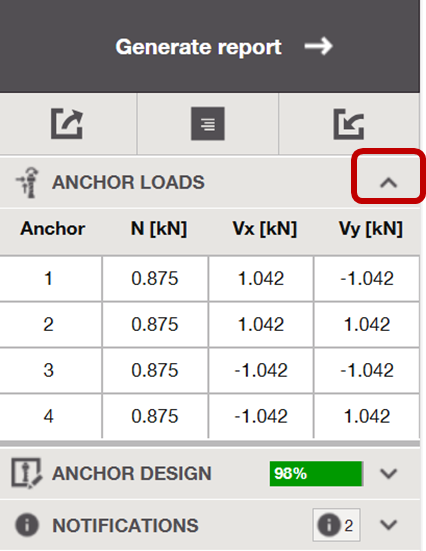

  2. View the Anchor Loads
    Expand or collapse the Anchor Loads section using the arrow next to it.
    Here, you can review the loads acting on each anchor based on your inputs.

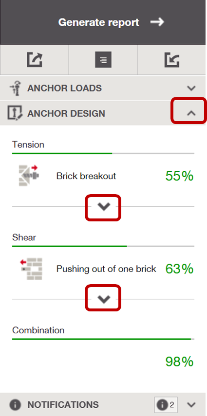

  3. Review design results
    Expand the Anchor Design section to view the overall design results.
    Use the arrows under each load type to see the utilisation of individual failure modes.

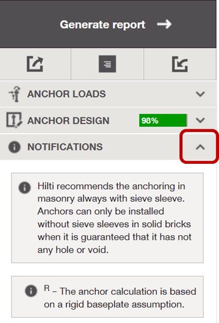

  4. View Notifications
    Open the Notifications section to review design tips, warnings, and error messages.

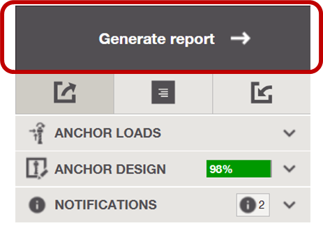

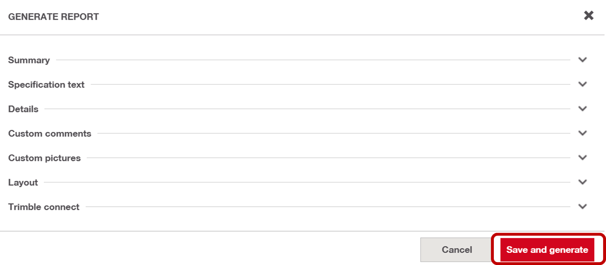

  5. Save and generate detailed design report
    Click Generate report on the right-hand side of the screen.
    In the pop‑up window, customise as needed, select Save and generate to create a full detailed design report.
Tip
When evaluating results, it is essential to first examine the governing failure mode and its corresponding utilisation percentage. Minor modifications to geometry, embedment depth, spacing, or load direction can alter the governing mode; therefore, reassess the input parameters if the design is either overutilised or underutilised.
