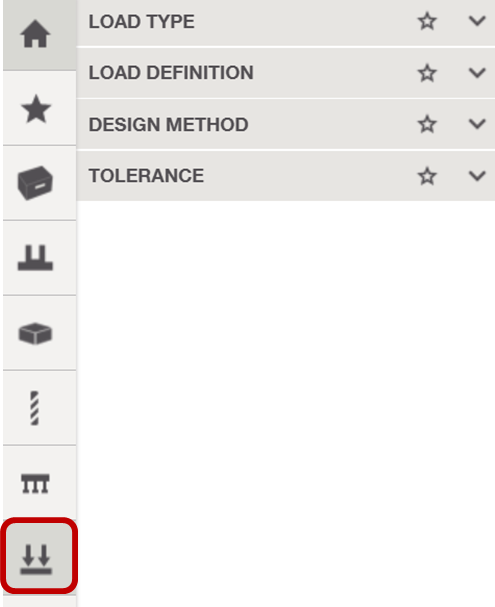

  1. Go to Loads / Calculation Type
    In your Anchor channel design workspace, go to the Load type tab on the left-hand side of the screen.

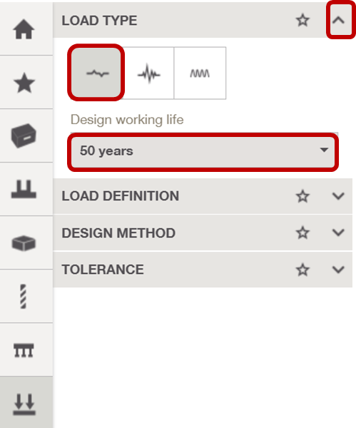

  2. Select the Load type and design working life
    Go to Load type and select the desired option.
    The Static load option is enabled by default.
    Choose the desired working life from Design working life dropdown menu.

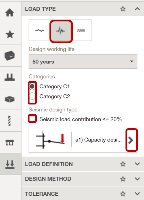

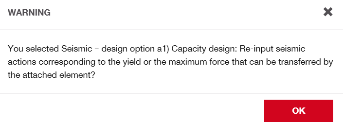

  3. Define Seismic load type (if applicable)
    Go to Load type and select the seismic load option.
    Seismic - design option a1) is selected by default.
    In the pop-up window, click OK.
    Select the suitable seismic design category and Seismic design type.

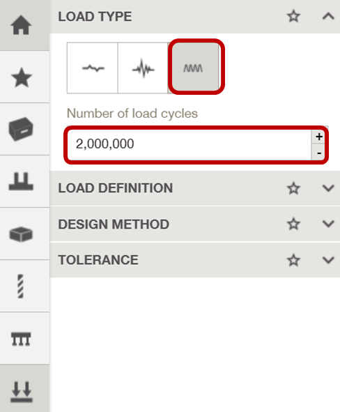

  4. Define Fatigue (if applicable)
    Go to Load type and select the Fatigue design option.
    Enter the Number of load cycles.

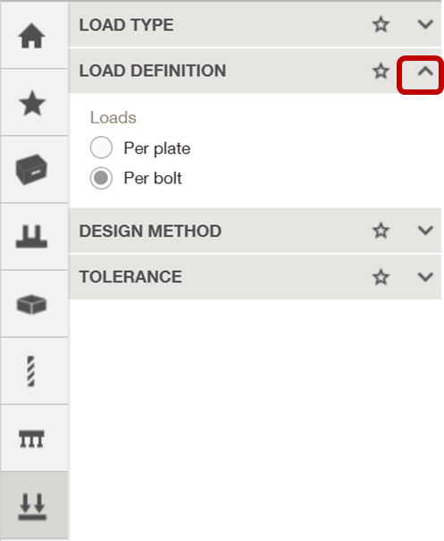

  5. Select load input type
    Go to Load definition and choose suitable load input type from available options.

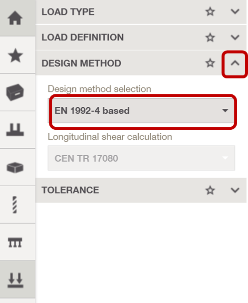

  6. Select the design method
    Go to the Design method and choose the desired option from the dropdown menu.

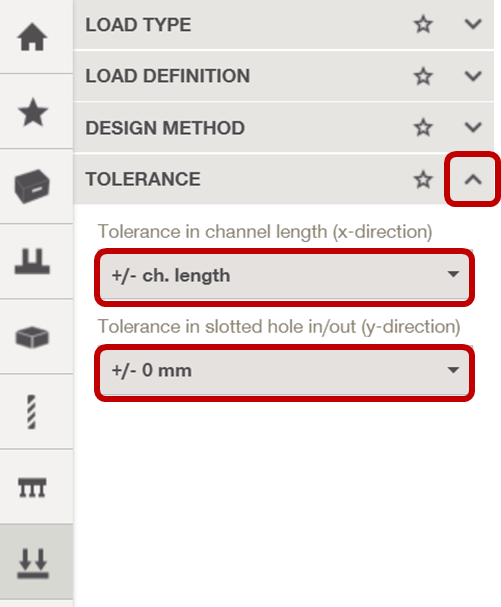

  7. Define Tolerance
    Go to Tolerance and select the suitable option from dropdown menu.
    Note:
    • This section in enabled only for Anchor channels and Cast-in anchors.
    • The dropdown menu for Tolerance in slotted hole in/out becomes visible only when Load per plate input type is selected.
