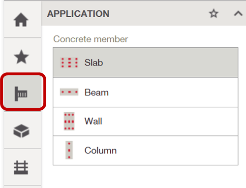

  1. Open the Application tab
    In your Shear strengthening design workspace, navigate to the Application tab on the left-hand side of the screen.
  2. Select the application
    Under concrete member, choose from:
    • Slab
    • Beam
    • Wall
    • Column

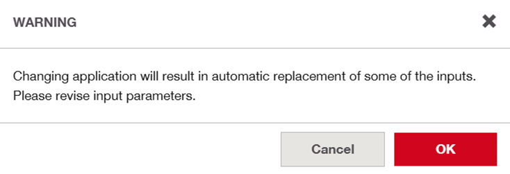

    Read the warning message in pop-up window and click OK.
