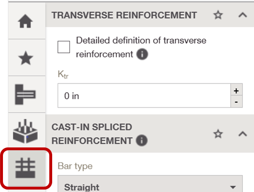

  1. Open the Existing reinforcement tab
    In your Concrete to Concrete design workspace, navigate to the Existing reinforcement tab on the left-hand side of the screen.

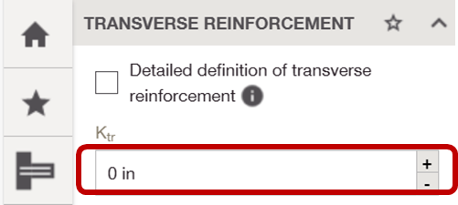

  2. Define transverse reinforcement
    Under Transverse reinforcement, enter the value for Transverse reinforcement index (Ktr) based on your project requirements.

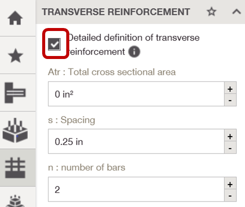

  3. Add detailed transverse reinforcement information (Optional)
    Enable Detailed definition of transverse reinforcement if you want to provide more specific reinforcement inputs.
    Enter values of Total cross sectional area, Spacing and Number of bars.
