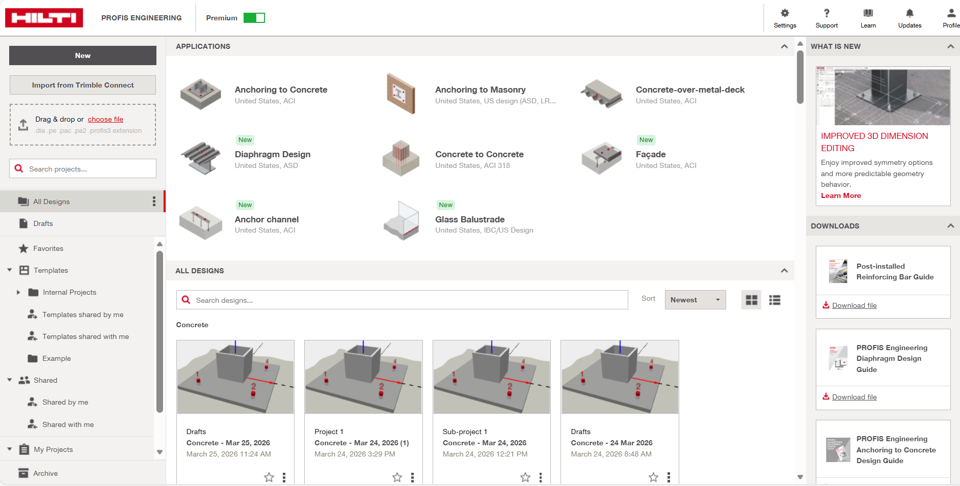

Interface overview
The home page of PROFIS Engineering is divided into several key areas, each providing access to a different part of your workflow.
  1. Top navigation bar
    Located at the very top of the screen, this bar provides quick access to system‑wide controls:
    1. Settings – Modify your region, units, and calculation defaults.
    2. Help – Access the Software Knowledge Center, contact support, and view software version information.
    3. Learn – Open the Engineering Trainings, Engineering Center, virtual tours, handbooks, and Hilti BIM/CAD library in other resources.
    4. Updates – View the latest software release notes.
    5. Profile – Manage your profile, subscriptions, and account settings.

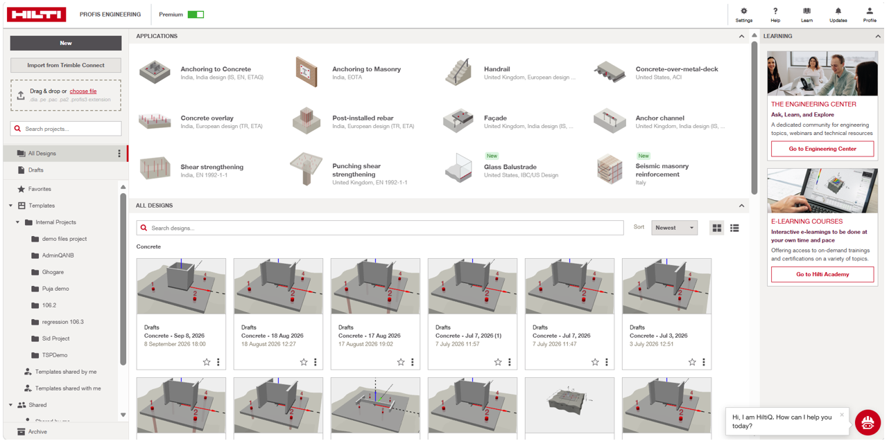

  2. Application area (Top section)
    This section displays all available design modules. Depending on your region, you may see:
    • Anchoring to Concrete
    • Anchoring to Masonry
    • Concrete‑over‑metal‑deck
    • Concrete to Concrete
    • Diaphragm design
    • Glass Balustrade
    • Facade
    • Anchor Channel, and more
    Click any module tile to start a new design.
  3. Left-hand navigation panel
    This vertical menu gives you access to your stored content:
    • All Designs – View all your files
    • Drafts – Access incomplete designs
    • Favorites – Quickly find frequently used files
    • Templates – View or manage templates you created or shared with you
    • Shared – Collaborate with your team
    • My Projects – Expand all your project folders
    • Archive – View archived projects.
    A Drag & drop or choose file upload area also appears here, allowing you to open existing design files quickly.
  4. Central workspace (Design library)
    The main section of the screen displays:
    • Recent designs
    • Designs grouped by module
    • Thumbnail previews of your files with file name, creation date, and quick options (e.g., open, share, archive)
    Scroll through this area to find previously created or frequently used design files.
  5. Right‑Hand Panel (Quick access & downloads)
    This panel provides shortcuts to:
    • What’s New announcements
    • Download materials
    • Learning resources
  6. New design controls (Top left corner)
    From the left side of the header:
    • New – Start a custom design
    • Import from Trimble Connect – Bring in geometry from connected models
    • Drag & drop or choose file – Open an existing PROFIS design file
