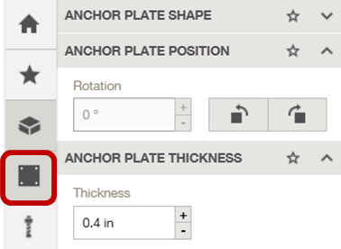

  1. Open the Anchor plate tab
    In your Anchoring to Masonry design workspace, navigate to the Anchor plate tab on the left-hand side of the screen.

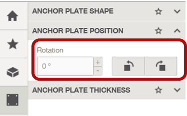

  2. Go to Anchor plate position
    Use rotation controls to turn the anchor plate left or right. Each click rotates the plate by 90 degrees.

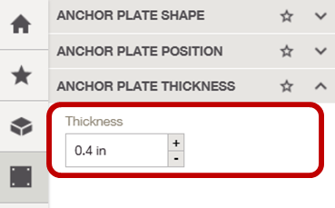

  3. Go to Baseplate thickness
    Here you can type in the thickness value or use the “+ / –” controls to increase or decrease it.
