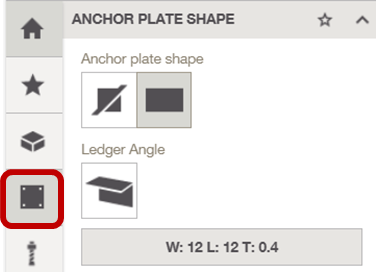

  1. Open the Anchor plate tab
    In your Anchoring to Masonry design workspace, navigate to the Anchor plate tab on the left-hand side of the screen.

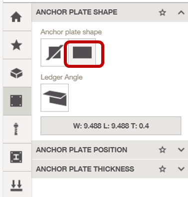

  2. Select the Anchor plate shape
    Go to Anchor plate shape and enable the baseplate.

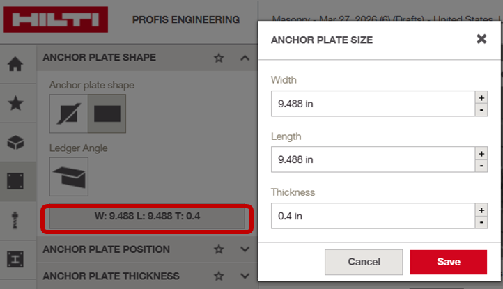

  3. Modify Anchor plate dimensions
    Under Anchor plate shape, click on the highlighted box to modify the anchor plate dimensions and then click Save.

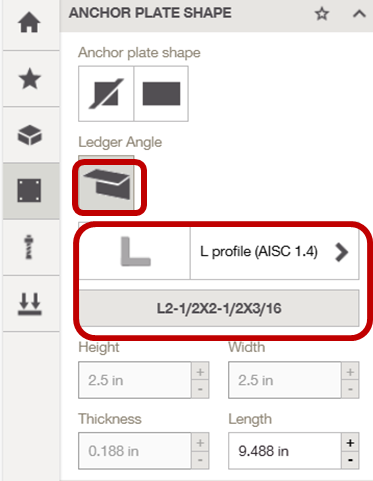

  4. Alternative Option: Ledger Angle
    PROFIS Engineering also allows you to select a Ledger angle instead of an Anchor plate.
    Note: When Ledger angle is selected, select the profile shape and size. You can also choose to customize the size.
