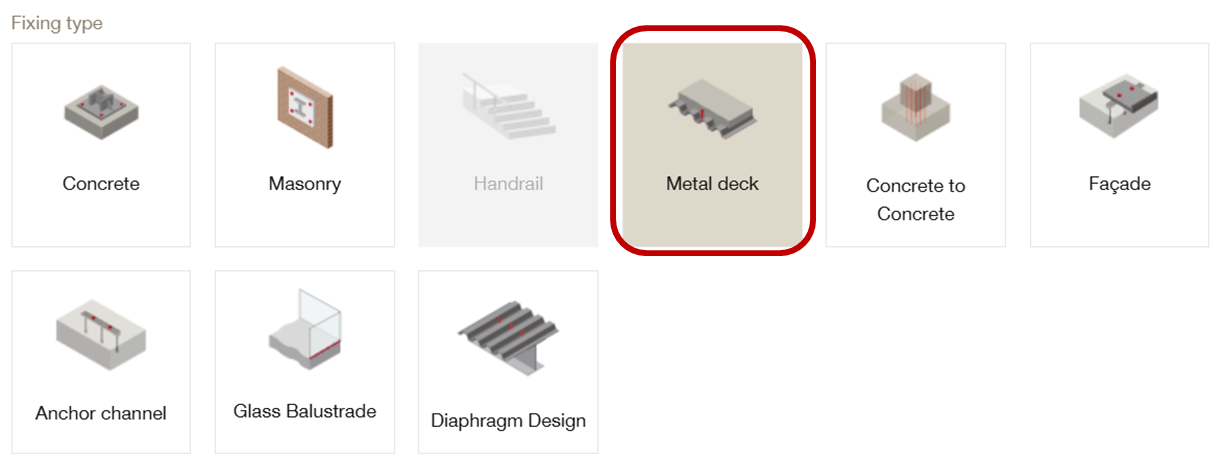

  1. Select the fixing type
    In the pop-up window, choose Metal deck from the fixing type options.

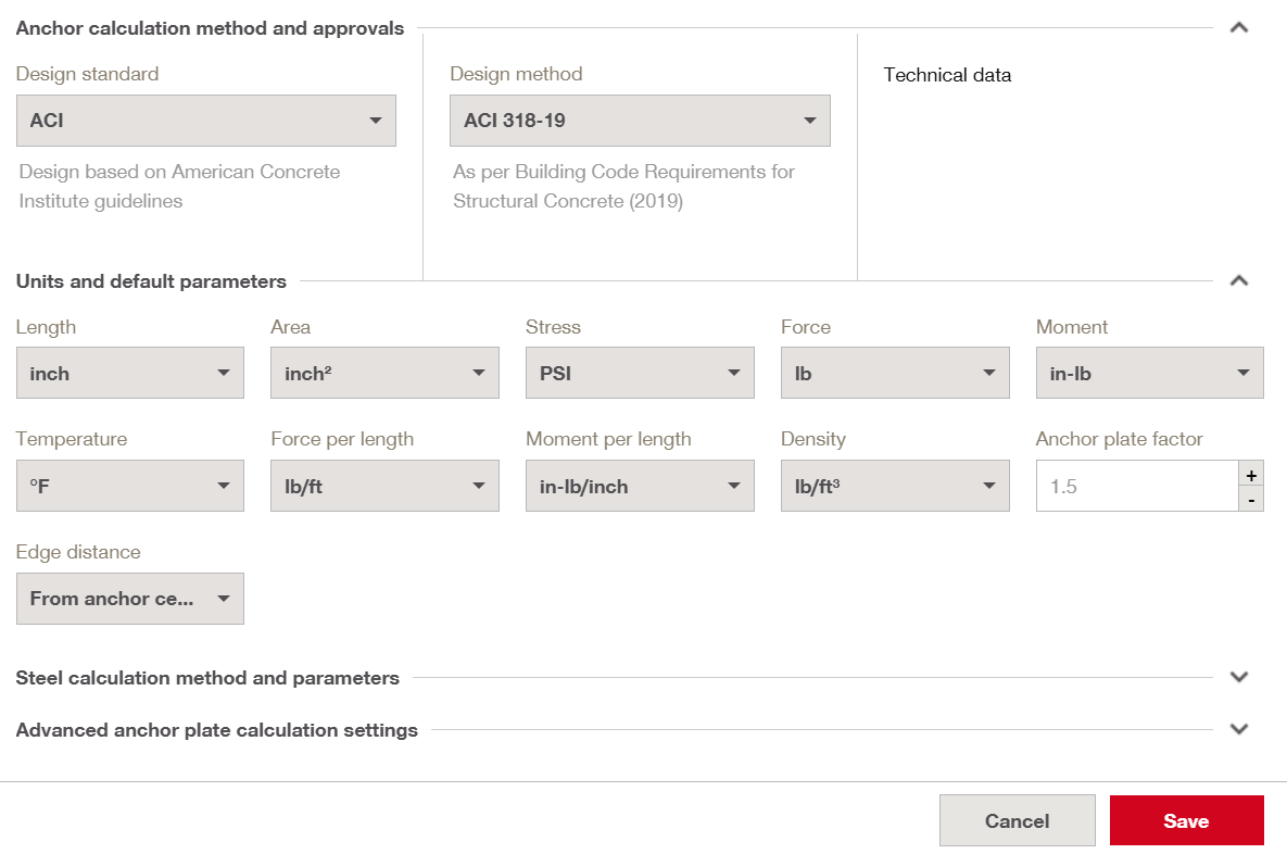

  2. Customize settings (optional)
    If needed, adjust:
    • Anchor calculation method & approvals
    • Units and default parameters
    Click Save once finished.

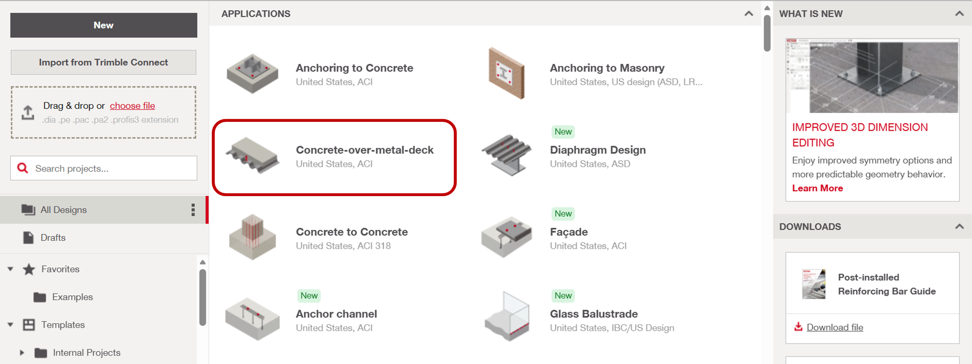

Alternative access method
On the PROFIS Engineering home page, you can also click the Concrete-over-metal-deck tile directly under the Applications section in the center panel.
