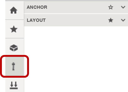

  1. Open the Anchor tab
    In your Concrete-over-metal-deck design workspace, navigate to the Anchor tab on the left-hand side of the screen.

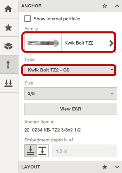

  2. Select the Anchor
    Under Anchor, select the desired Anchor Family, as ell as specific Type of fastening element, from the dropdown menu.

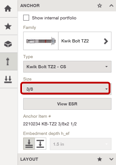

  3. Choose the Anchor size
    Select the desired anchor Size from the dropdown list.

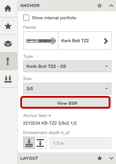

  4. View Product Approval
    Click View ESR to open the corresponding product approval document.

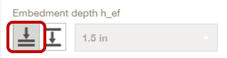

  5. Optimized embedment depth (Default)
    By default the, Optimized embedment depth is selected.
    Note: PROFIS Engineering automatically determines the optimized (minimum) embedment depth that results typically in high anchor utilization.

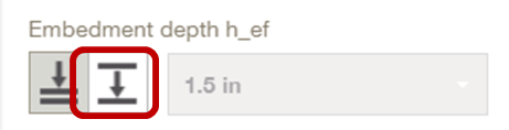

  6. Modify embedment depth (optional)
    To enter your own value, select User selected embedment depth.
