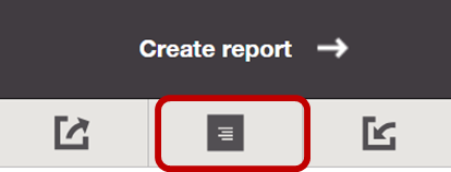

  1. Click the Specification text icon
    In your Concrete-over-metal-deck design workspace, go to the panel on the right-hand side of the screen and click the Specification text icon.
    Click Copy to clipboard to copy the specification text.

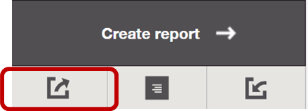

  2. Click the Export icon
    In your Concrete-over-metal-deck design workspace, go to the panel on the right-hand side of the screen and click the Export icon.

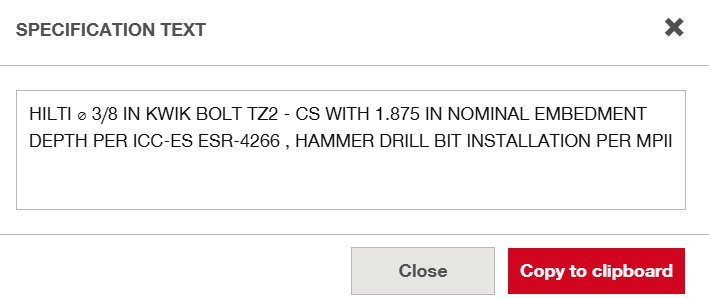

  4. Copy the Specification Text
    In the pop‑up window, click Copy to clipboard to copy the generated specification text.

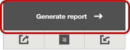

  5. Open the report generator
    Click Generate report on the right-hand side of the screen.

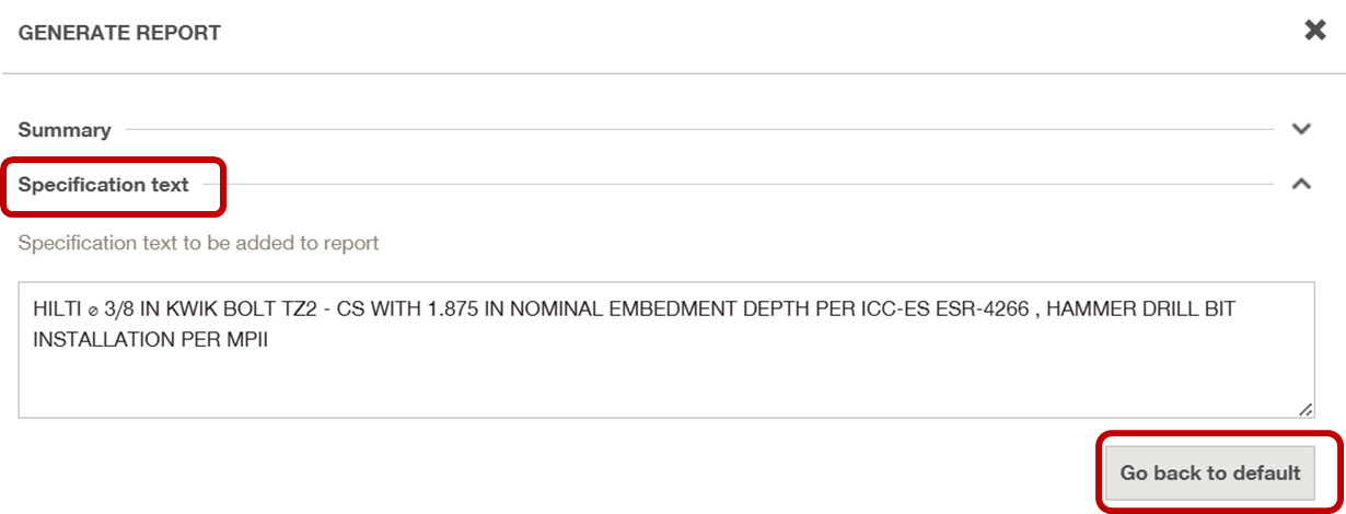

  1. Edit the specification text
    In the pop‑up window, update the Specification text as needed.
    Select Go back to default to restore the original version at any time.

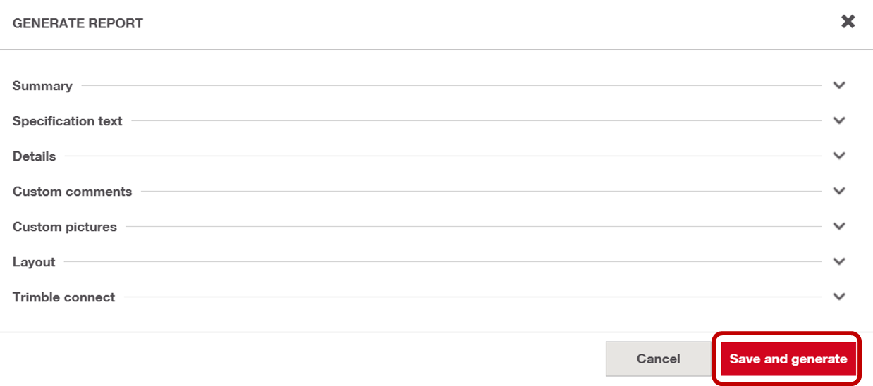

  2. Save and generate the report
    Click Save and generate to create a detailed design report that includes your modified specification text.
