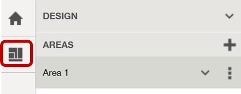

  1. Open the Areas tab
    In the Diaphragm Design workspace, navigate to the Area tab on the left-hand side of the screen.

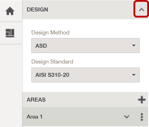

  2. Open the Design section
    In the Areas tab, navigate to the Design section on the left-hand panel.
    This section contains the inputs for Design Method and Design Standard.

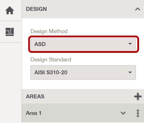

  3. Select the Design Method
    Under Design Method, open the dropdown menu and choose the required design philosophy.

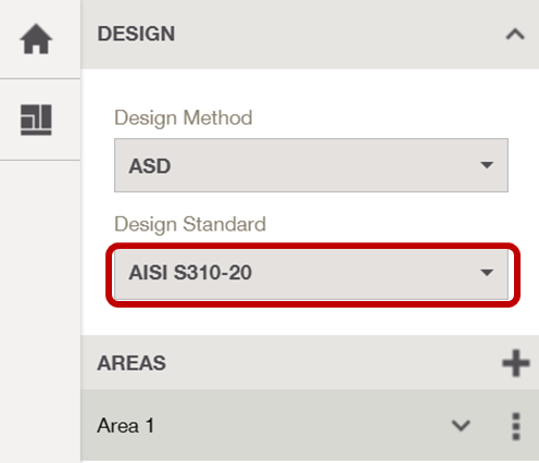

  4. Select the Design Standard
    Under Design Standard, choose the applicable code from the dropdown list.
