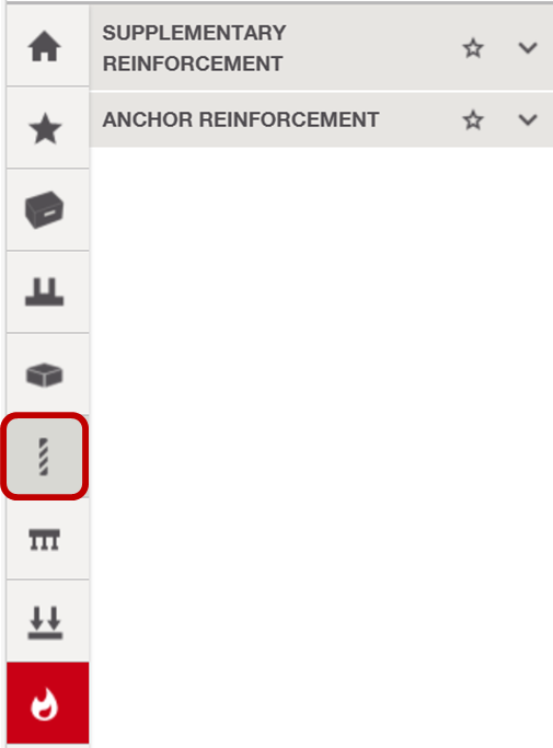

  1. Open the Supplementary reinforcement section
    In the Anchor channel design workspace, navigate to Concrete reinforcement tab on the left-hand side of the screen.

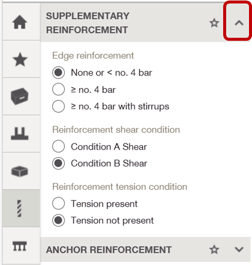

  2. Open the Supplementary reinforcement section
    Expand the Supplementary reinforcement section.

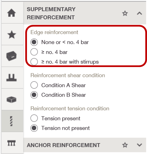

  3. Define Edge reinforcement
    Under Edge reinforcement, select the option that best represents the reinforcement near the concrete edge:
    • None or < no. 4 bar
      • Select when no significant edge reinforcement is present, or bars are smaller than No. 4.
    • ≥ no. 4 bar
      • Select when reinforcement bars of size No. 4 or larger are present near the edge.
    • ≥ no. 4 bar with stirrups
      • Select when No. 4 or larger bars are present together with stirrups providing additional confinement.

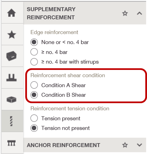

  4. Define Reinforcement shear condition
    Under Reinforcement shear condition, choose one of the following:
    • Condition A Shear
    • Condition B Shear
    This setting defines how reinforcement contributes to shear resistance according to the applicable design provisions.

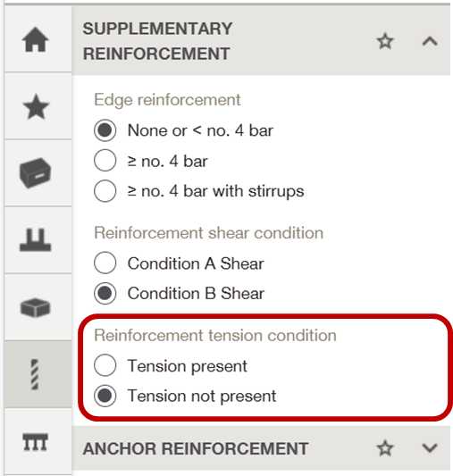

  5. Define Reinforcement tension condition
    Under Reinforcement tension condition, select:
    1. Tension present – When tensile reinforcement crosses the potential failure surface.
    2. Tension not present – When there is no reinforcement contributing to tension resistance.
    This affects how PROFIS Engineering evaluates tension‑related failure modes.
