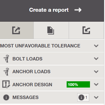

  1. Go to the Results and Notifications panel
    In your Anchor channel design workspace, open the Results and Notifications panel on the right-hand side of the screen.

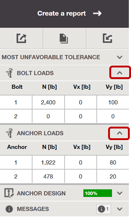

  1. View the Loads
    Expand or collapse the Anchor Loads / Bolt Loads section using the arrow next to it.
    Here, you can review the loads acting on each anchor/bolt based on your inputs.

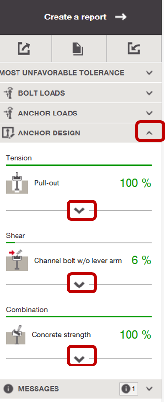

    Expand the Anchor Design section to view the overall design results.
    Use the arrows under each load type to see the utilization of individual failure modes.

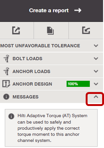

  3. View Notifications
    Open the Messages section to review design tips, warnings, and error messages.

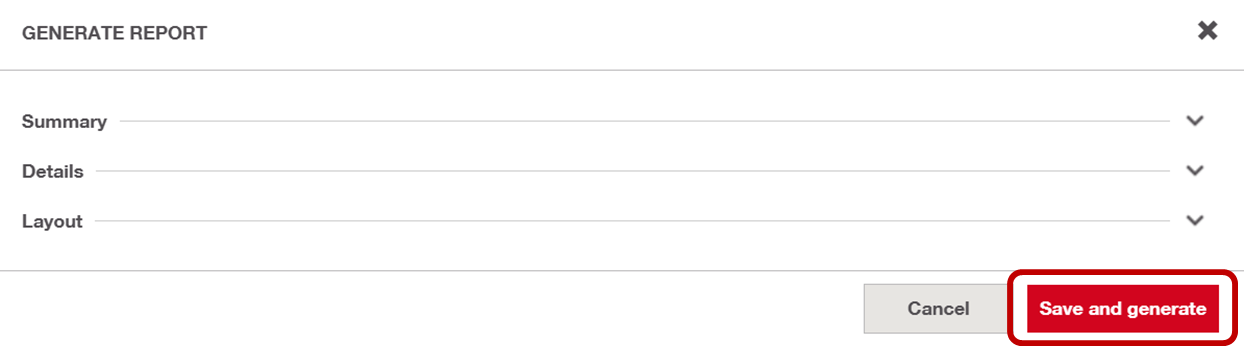

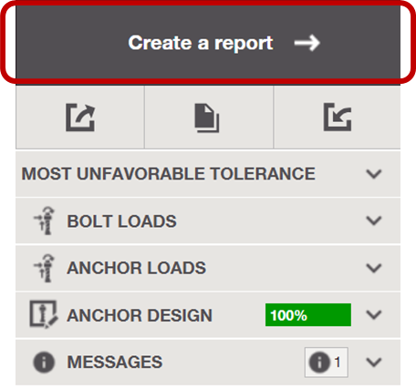

  4. Save and generate detailed design report
    Click Create a report on the right-hand side of the screen.
    In the pop‑up window, select Save and generate to create a full detailed design report.
