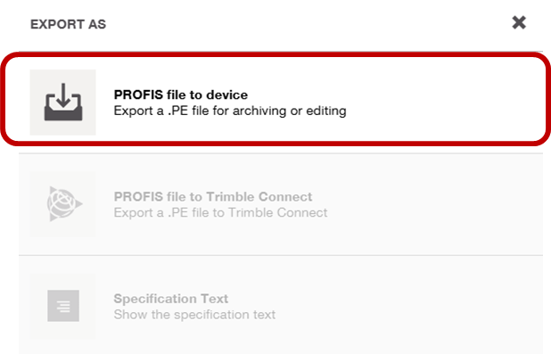

  1. Click the Export icon
    In your Anchor channel design workspace, go to the panel on the right-hand side of the screen and click the Export icon.
  2. Save the PROFIS design file
    From the export options, choose PROFIS file to device.
    The file will be automatically saved to your downloads folder or your predefined system folder.
