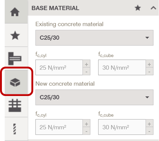

  1. Open the Installation Conditions tab
    In your Post-installed rebar design workspace, navigate to the Concrete member tab on the left-hand side of the screen.

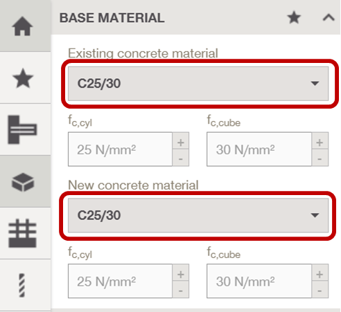

  2. Select concrete grade
    Choose the appropriate Concrete grade for existing and new concrete material from the dropdown menus. Cracked concrete option is not enabled for Lap splice connection. It is applicable only for End anchorage connection.
