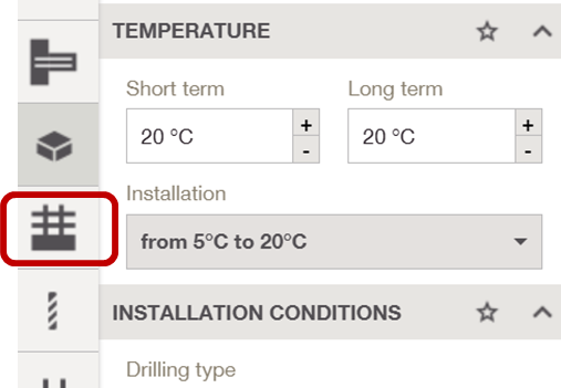

  1. Open the Installation Conditions tab
    In your Post-installed rebar design workspace, navigate to the Concrete member tab on the left-hand side of the screen.

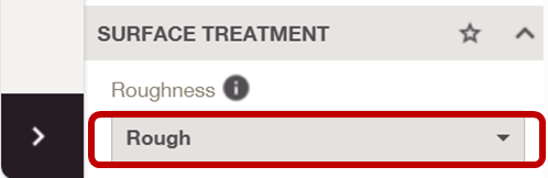

  2. Define Surface treatment
    Under Surface treatment, select the appropriate roughness from the dropdown menu to reflect the interface preparation used on your project.
Tip
Click the information (i) button for additional guidance on the available surface treatment options.
