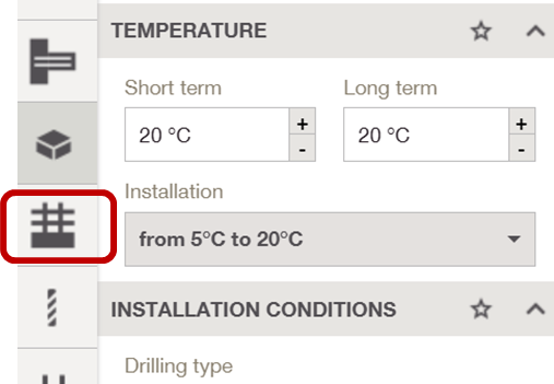

  1. Open the Installation Conditions tab
    In your Post-installed rebar design workspace, navigate to the Concrete member tab on the left-hand side of the screen.

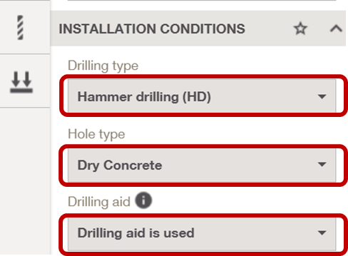

  2. Define Installation Conditions
    Under Installation Conditions, choose the appropriate Drilling type and Hole type from the dropdown menus.
    Use the Drilling aid dropdown to specify whether a drilling aid is used.
