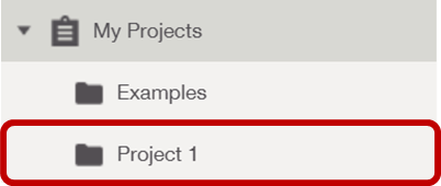

  3. Go to your project
    In the PROFIS Engineering home page, go to My projects on the left-hand side of the screen and click on your project folder.

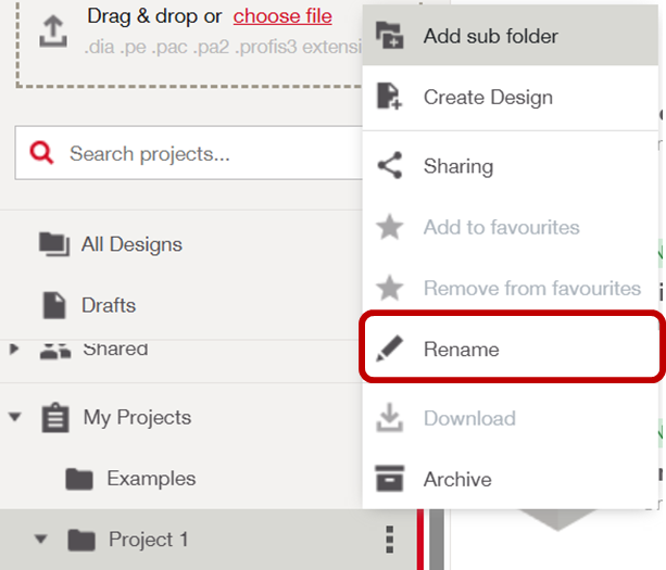

  4. Rename the project folder

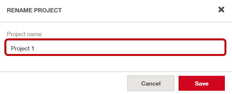

    Click the three dots on the selected project and choose Rename from the list.
    In the pop-up window, enter the new name for the project and click Save.
