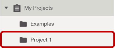

  3. Go to your project
    In the PROFIS Engineering home page, go to My projects on the left-hand side of the screen and click on your project folder.

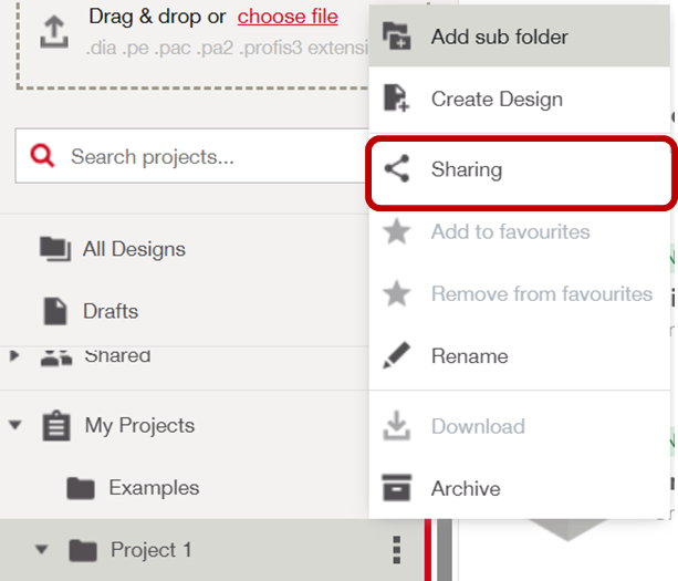

    Click the three dots on the selected project and choose Sharing from the list.

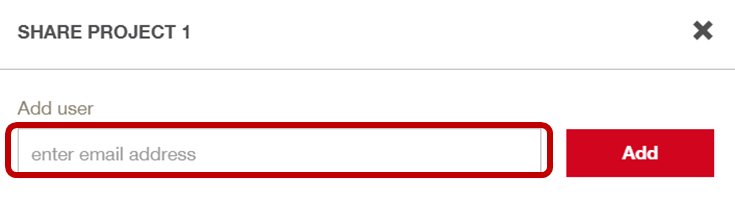

    In the pop‑up window, enter the email address of the person you want to share the project folder with and click Add.
