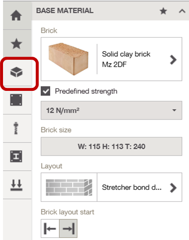

  1. Open the Base material tab
    In your Anchoring to Masonry design workspace, navigate to the Base material tab on the left-hand side of the screen.

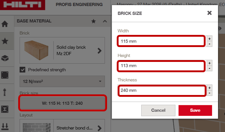

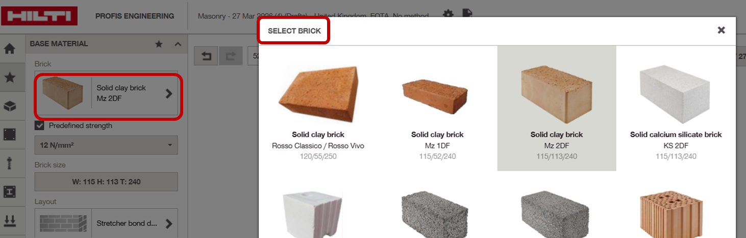

    Click on Brick and choose the appropriate Brick type.
    Click on Brick size to modify brick width, height and thickness (if applicable).

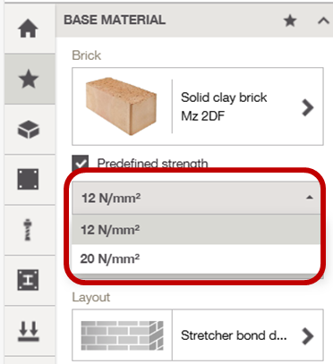

  3. Define brick strength
    Select brick strength from dropdown list, or
    disable Predefined strength to enter the value manually.

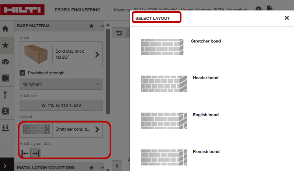

  4. Input brick layout
    Under Layout, select brick layout pattern and staring point.
