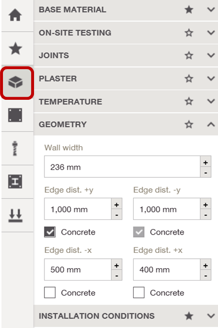

  1. Open the Base material tab
    In your Anchoring to Masonry design workspace, navigate to the Base material tab on the left-hand side of the screen.

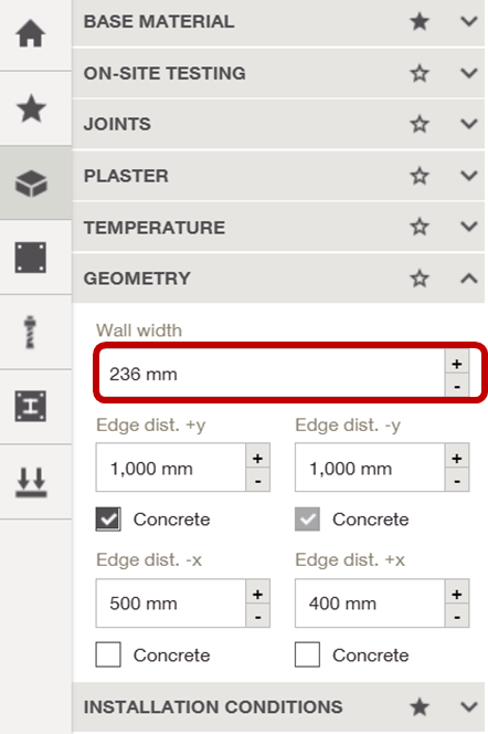

  2. Enter wall thickness
    Type the wall thickness directly into the input field or use the + / – controls to adjust the value incrementally. For english bond layout, wall thickness is a fixed value.

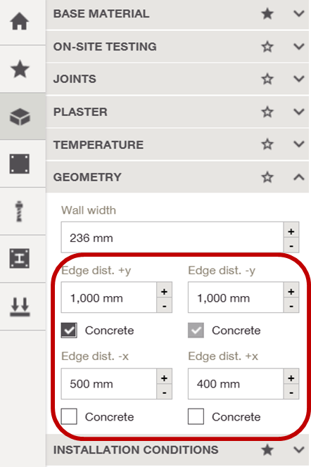

  3. Define edge distances
    For each direction, enter the required edge distance.
    Use the checkboxes when you would like to lock the edge distance in a specific direction.
