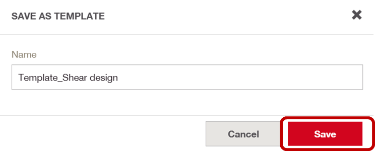

  2. Name your template
    In the pop‑up window, enter a name for your template and click Save.
